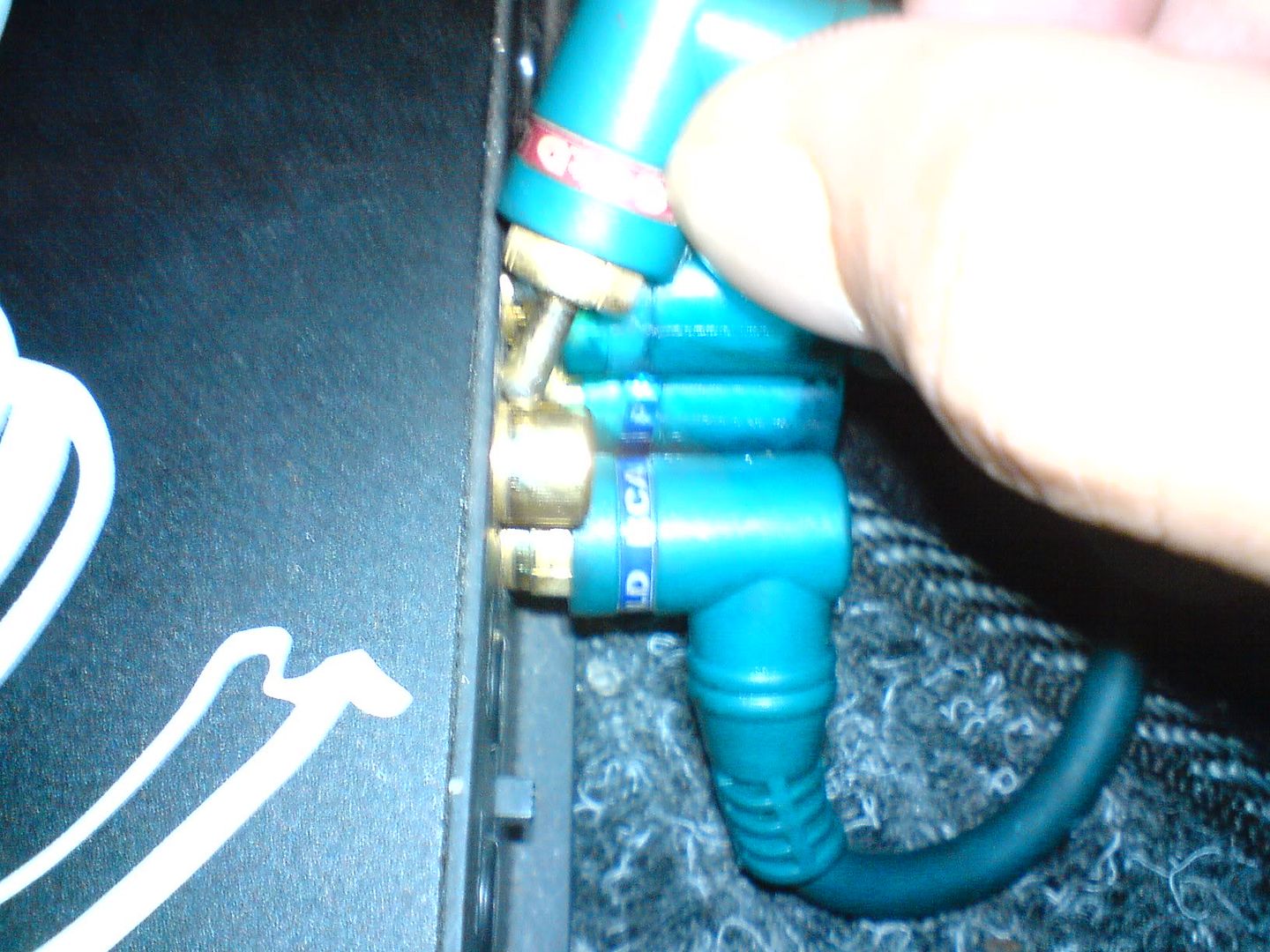

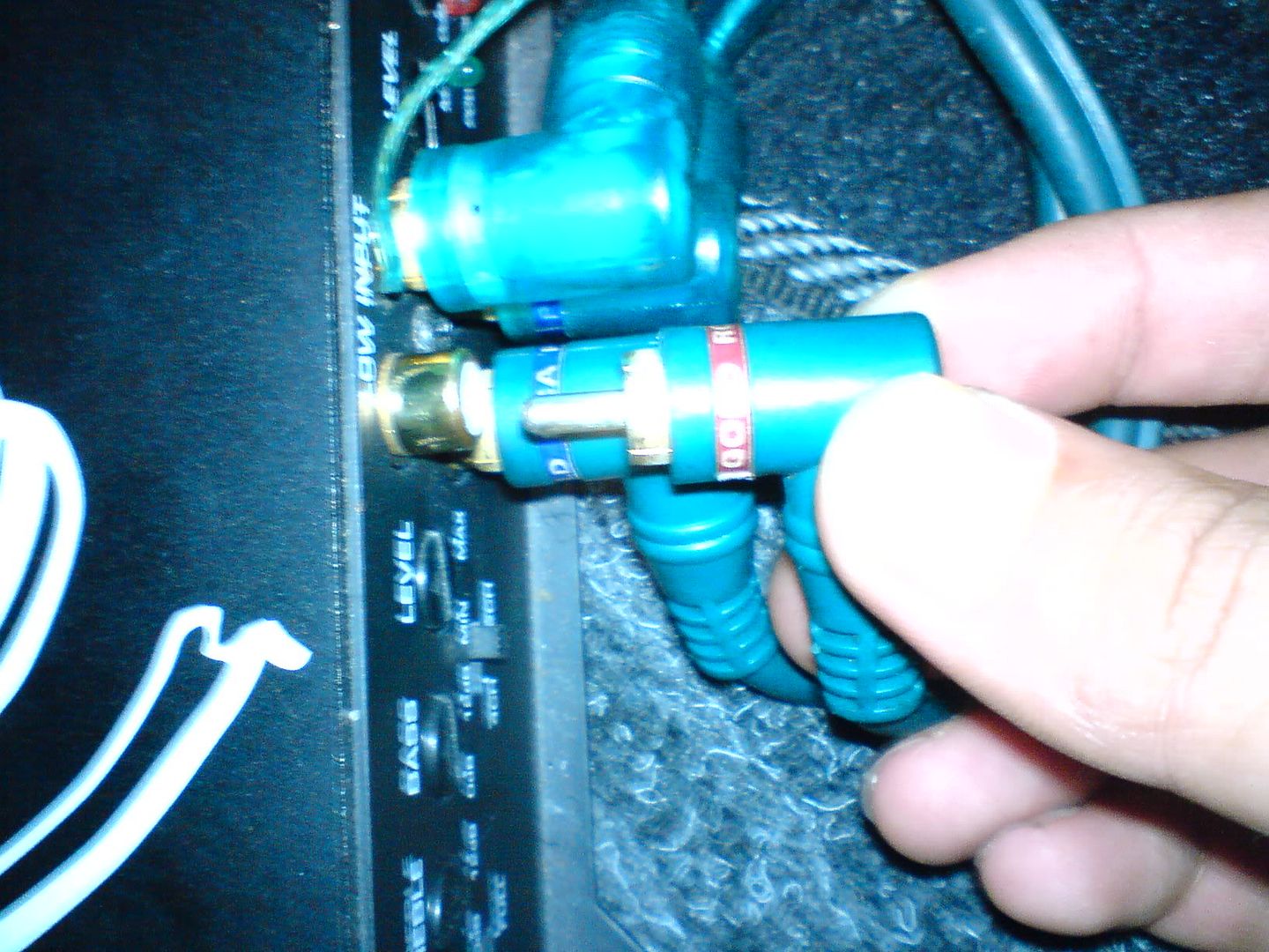

my prob is the same. before this it was good, suddenly it became like this. any idea why?
usually some wire got loose, just check rewiring.
almost all noise issues are ground related, however many wires got ground, so must check RCA cables, speaker wires, amp ground wires, etc etc...
when i disconnect this cable, there is no airplane sound
when i do like this, all speaker no sound...
so what is the prob? what should i do?
try changing around the cables see if the problem is with the cable itself or the amp rca terminal, may have been disconnected inside the amp board.
