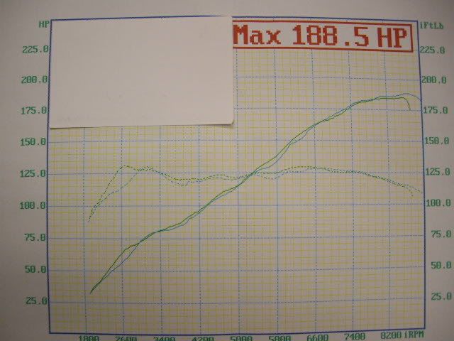

To share with you guys then :burnout:
A test done in August 2007.
Stock B18C-R Bottom end except milled slightly to ensure flat
B16A head fully hand ported by my sifu with valve angle job
Omni Power Valve Springs + Omni Power Ti Retainer
Engine was running since last year August, used for a 7 hour MME race before retirement due to gearbox, then used it for 2 MSS race and a few sunday track days.
In August this year, with the same engine which is already very tired and losing compression, i decide to just bolt on some more parts to test before re-building the engine this month, :biggrin:
So addition (some new & some old) to the old and tired engine before it is tuned with Hondata:-
Intake Side
Skunk2 Pro-Series Intake Manifold
J's Racing 65mm Throttle Body
Velocity Stacked with K&N filter
Exhaust Side
DC 4-1 Race header
Skunk2 Megapower R race exhaust
Head
Full porting with valve angle and head milled to increase compression
Omni Power Valve Springs + Ti Retainer
CTR valves
BC 4+ Cams
Block
100% Std 87.2mm crank, std rods, std 81mm piston, std rings
Block milled to ensure straight ness.
Tuned with Hondata S300 with peak power a/f at 12.8 a tappering down to 12.5 at rev cut.
Results on dyno-dynamic 188.5whp @ 8800rpm and average torque of 125wFtlb.
Nothing to shout about but i felt it is decent considering the loss of compression on an old engine. :biggrin:
Dyno Chart http://i80.photobucket.com/albums/j178/thtan777/B18CBC4.jpg

Woah.. 188 atw.. with compression loss, heh.
BTW, why is there a torque spike at lower end of the RPM? it seems you're making better torque at lower revs than at high revs.. (O_o)
BTW, a slight note, the s300j has quite an aggresive low end ignition numbers I had mine retarded at 1-2 degs, while the upper maps I increased 1-2 degs. But that's the general idea, the end result was far from the stock version, as I based my ignition increases/decreases based on fuel maps and AFR.
Before my compression loss, it only takes me about 2secs+ to rev from 5+K rev drop in first to 8.3K :P
Oh well, hope fully the valve job (after I get the valves) would curb that problem. I'm contemplating a bit of compression increase from use of low comp valves, but results have to wait till later.
188whp is still not too shabby.. but it's hard to stay competitive when everyone else is making more, isn't it? (O_o)

from the graph of dyno i could c the car lag of timing from rang 3000-5000 rpm its could doing more better
from the graph the cam hold up to btw 8600-8700 rpm n start drop
maybe its cause by compression loss
usually what caused to loss compression? worn out piston rings? what else?

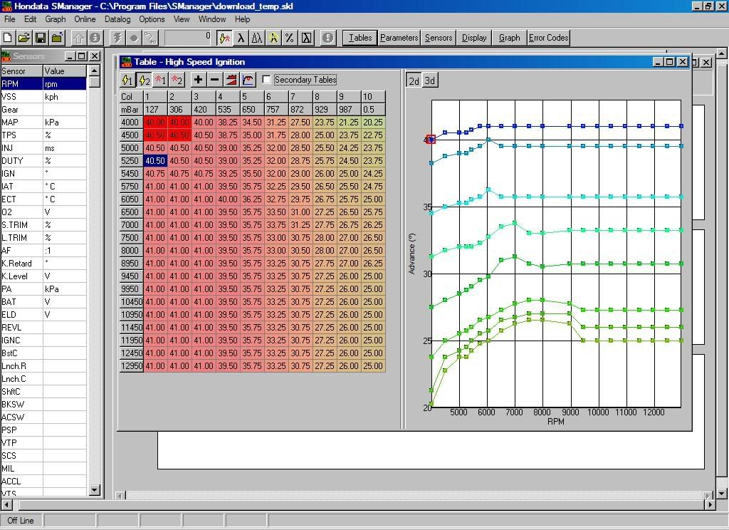

Hehehe... well if you guys want to know see my ignition map, here.
Don't use it in your car though, because I only tuned up to 8.5K, not 9K, the 9K is extrapolated. If you use and suffer knocking, then obviously it's not suited for your engine. So if you feel like using (USE AT YOUR OWN RISK.)
only part throttle is not tuned, as you can see, it's still stock S300 mapping for part throttle probably with 1deg-2deg +/- adjustment.. I could be fickle at tune it, but meh, time issues.
I can run my car in open loop mode though, Becaused I spent a lot of time tuning the bottom end for more response for daily driving purposes.
download_temp.skl means I downloaded it from my ECU.
Current compression loss is worrisome and irritating.
