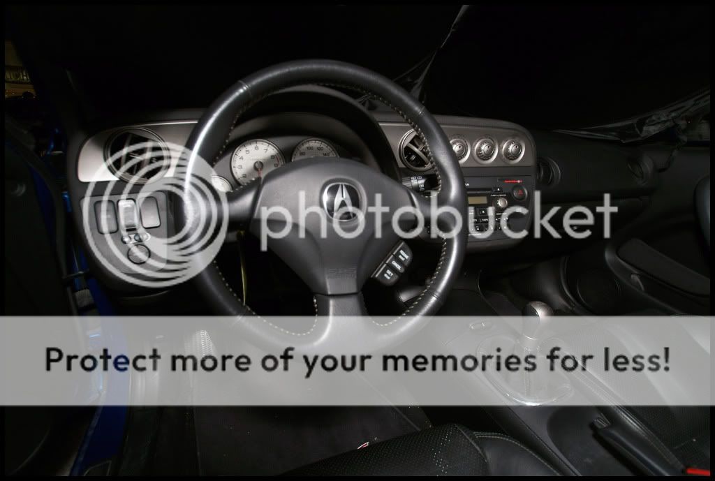

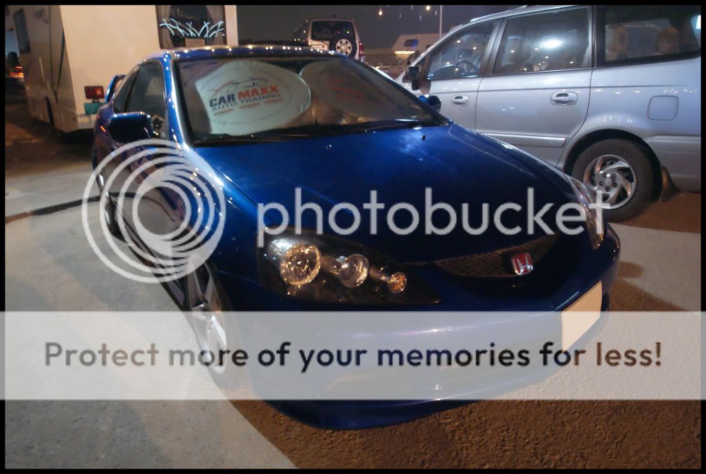

Dear fellow Integras,
Need helps and opinions from the pros. I'm currently working in the middle east and its my first time spotted an Integra in this desert country. Its my dream car since high school and its the main reason for me to work here. The car just arrived 3 days ago from US. It seems like an Acura RSX or Integra Type-S to me but the salesperson said its a Type-R. But I aint that 100% sure. Its a 2006 car with 74000km mileage at a selling price or RM55,000 (exchange rate is almost 1:1). My big dilemma is that the car is left hand drive. It isn't a problem for me here, but i believe it will be a big issue if it is being brought back to Malaysia. Thus, I'm researching on the cost to exchange from left handed driver to right handed. The salesperson mention that is was an easy job but i really doubt so. Does anybody have info on this, cost & method? If so, it is worth the price of rm55,000 with the cost of changing (assuming that i manage to obtain an AP)?

Nice car, looks like a type S (without the Recaro and red engine valve cover) but the Honda emblem is Red in color. Is it a 5 speed manual or 6 speed? does it comes with Brembo Brake calipers? Conversion can be done here and I knew someone who bought a 2 Door CIvic Si left hand drive from US and convert it to RHD in Malaysia. They need a RHD dashboard & mechanicals to relocate the Steering system and the controls . Not sure about the cost (My estimate is RM5-7K) , but it can be done here. Plus the price they offered you is good considering its a new face lift and its a 2006 model. Good Buy!
Here are my thoughts:

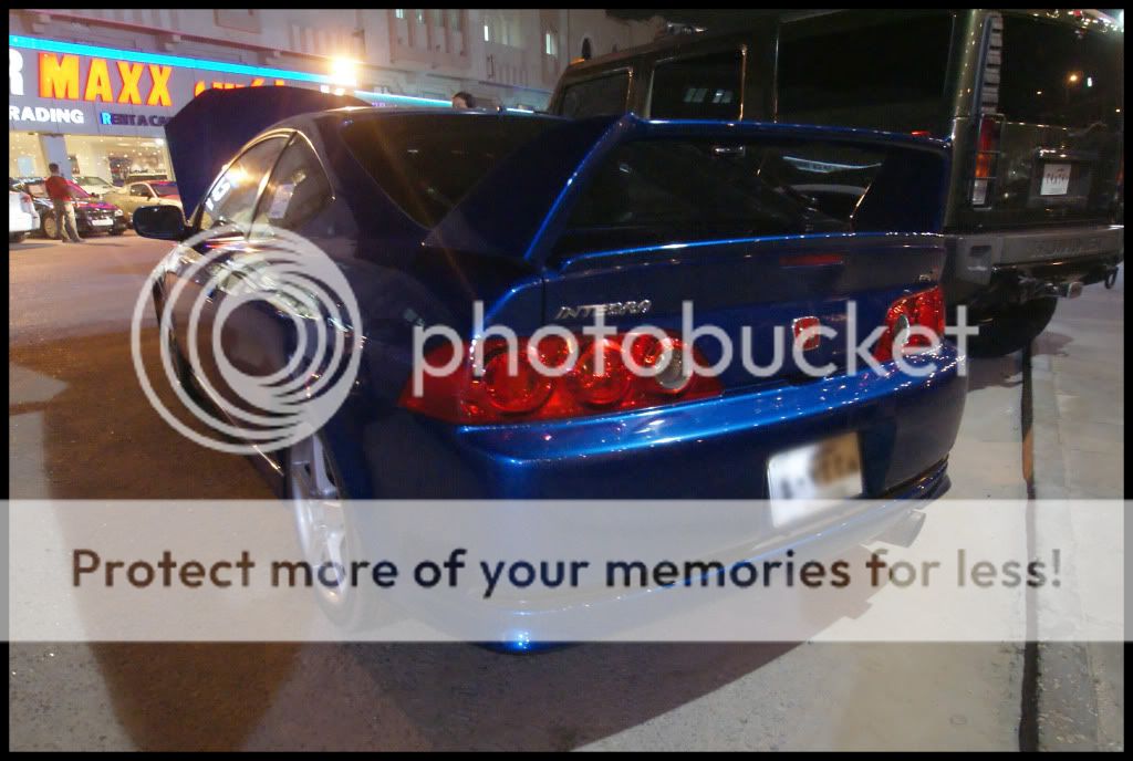

1. there is no LHD Type-R DC5 available in the market. most likely yours is an Acura RSX Type-S (based on the manual gear stick I saw) which boasting slightly lesser power than the Type-R.
2. the car was only equipped with the JDM red H emblem front and back, 'Integra' and 'Type-R' emblems. The facelift taillights is still representing an Acura RSX with red middle light. the Type-R's taillights should be clear in the middle, just like the reverse lights. refer below pic:
3. Wheels are still Acura RSX and presumably the brakes are non-brembo.
4. LHD conversion to RHD is POSSIBLE in Malaysia, but be ready to spend countless amount of money. Type-R dashboard will set you around 1-3k (used), steering rack is around 2-3k and manual pedals with related parts will cost you around 1-3k. Conversion costs will be a bomb where your chassis frame and firewall might be tampered / welded to make way for brake pump, gear linkage etc. i might miss out something but im sure as hell that TONS of parts required to make the conversion perfect. Its pretty insane to do this plus you might encounter problems later on with the enforcement should your conversion does not pass their standard (is there any law a RHD-LHD / LHD - RHD conversion is Malaysia?)
5. The other way you can make it is to buy the entire front cut of a DC5 Type-R and swap everything to your car (accept for the frame). Again, it will also cost you around 20k just for the front clip..plus, tamperation of the chassis will still need to be done to the car.
6. Since you're returning back to Malaysia, i suggest that you scrap the idea of buying this car and get the authentic Type-R. you might be earning good since you're working in the middle east (most of my friends are!). save some money, come back home, get the real deal, be a happy man.
