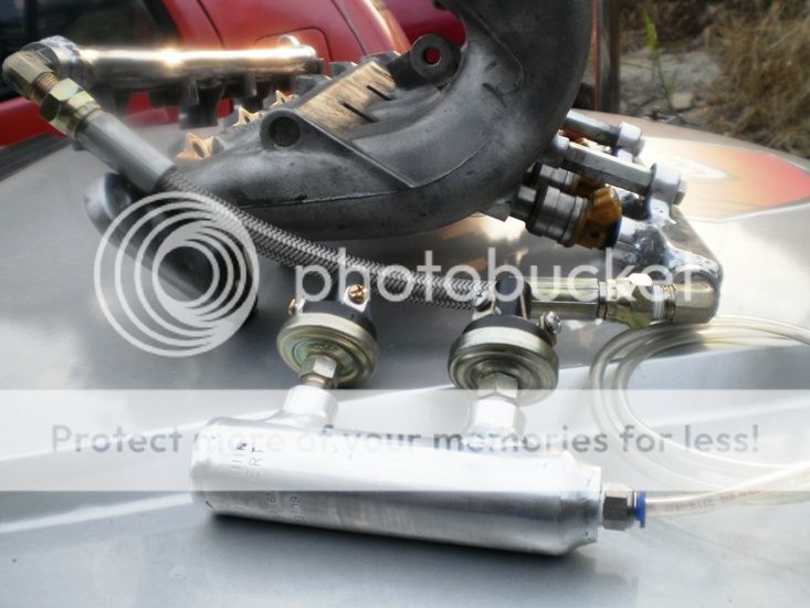

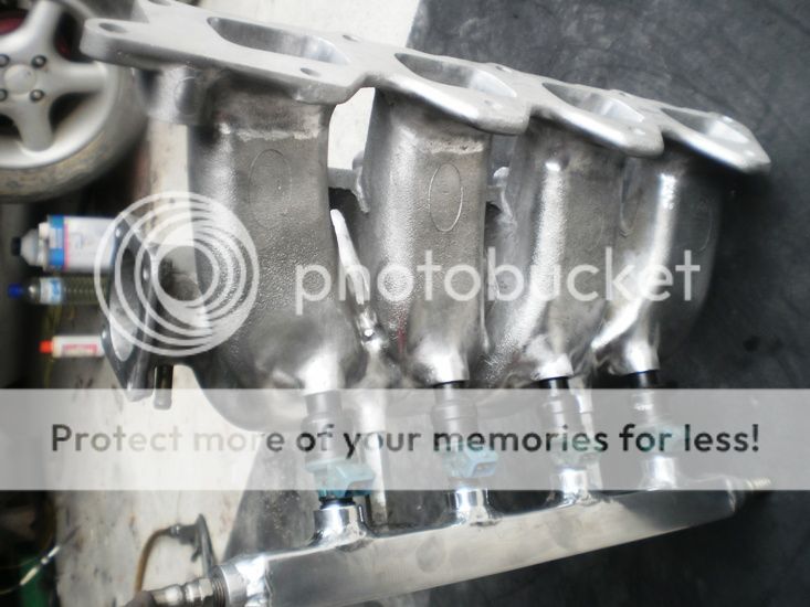

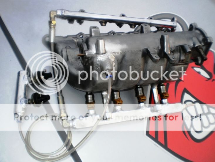

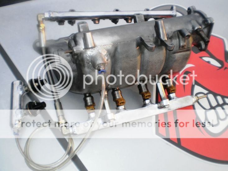

I know somebody will fell its like old tech since now have many option to solve fuel problem for turbo set up...somebody ask me to make twin fuel rail..so this is the pics...but i keep thinking what the best way for fuel line set up to this rail....
Fuel pump change to rx7 fd,Fuel line from tank to rail done,use brided hose go inside...only from filter to rail..?-Fuel regulator..?-Line back to tank..? any suggestion...

its is usually front pump to a Y , split to two fuel rails, return of both rails go into a Y back , back to the regulator

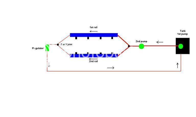

thanks,after read your post,i try to draw...plz correct if there any wrong or can add something...:nurse:
secondery injector run in stage...boost

No sir,its only petrol...as u can see..i make air reservoir and 2 boost sensor..its can switch current
buy adjusting any point boost we want...i sure its must be common device for u sir...without using any piggy back,more like Diy...can u or anybody here help to share how the best injector wiring should go...hope the boost sensor there can usefull in this Diy...:idea::nurse:
its gonna fail as you are not using piggyback , how are you gonna control the time of the injectors , u cant just switch it on all the time , its gonna flood for sure as you cant be spraying all four cylinders at one go , it has to synch with the other primary injectors
the old school style is to place the extra injectors b4 the TB , thus all four cylinders get a little extra
