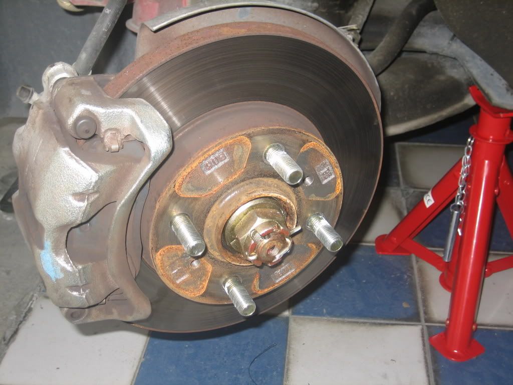

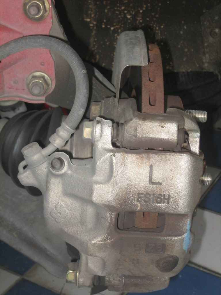

Here I upload picture of my front brake disc for reference:
Image Disc 1:
Image Disc 2:
Image Disc 3:

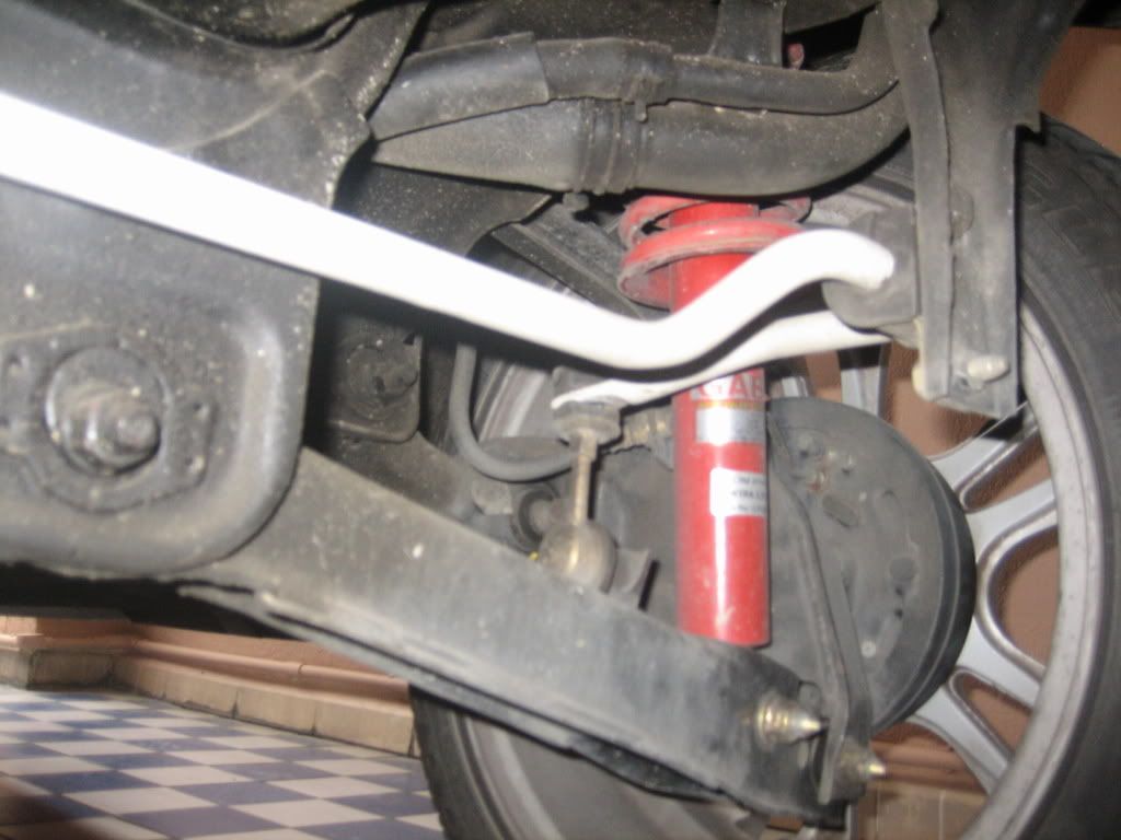

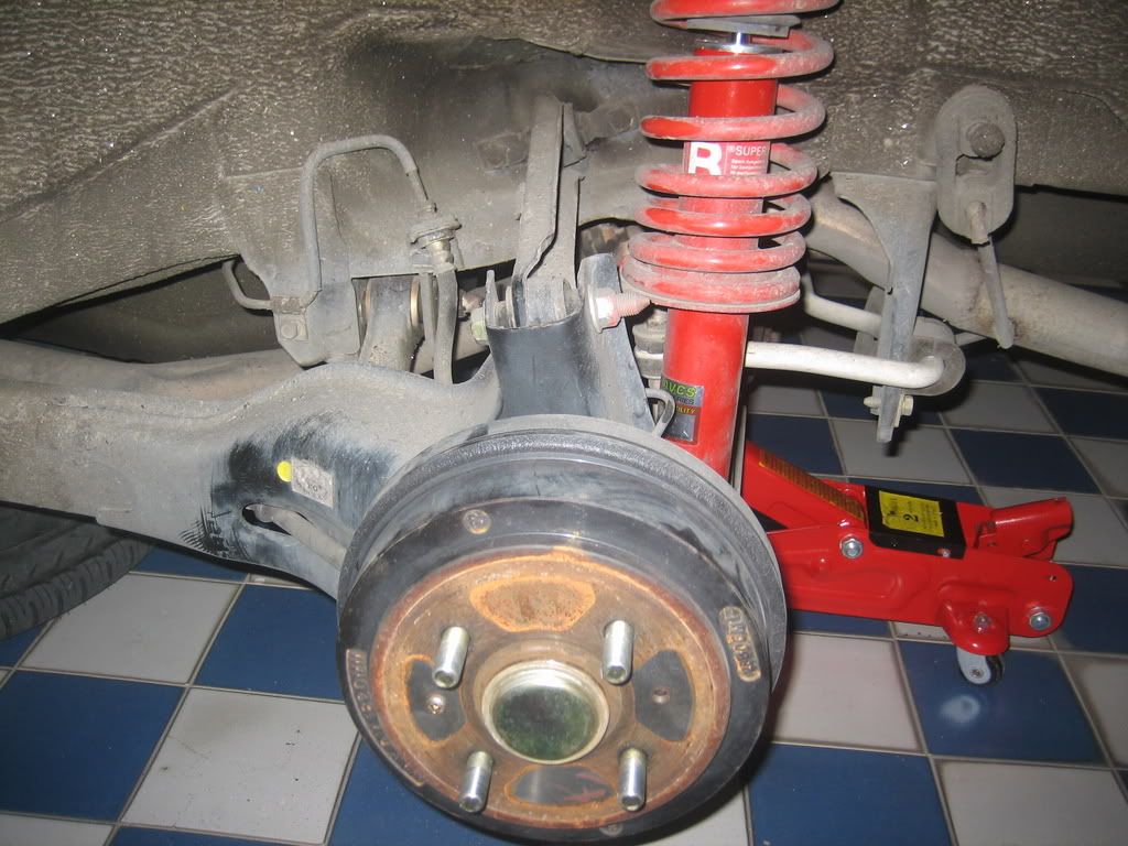

Here I upload picture of my rear drum brake for reference:
Rear Drum Brake 1:
Rear Drum Brake 2:
Well, I uploaded the picture for you guys easier to comment and pin point things. Thnx in advance. Will update. Latest update will be in BOLD. Thnx

Question is:
- Can someone point to me to in a picture that I've uploaded below which part is the "tapak" part? And which part is the knuckle? Sorry, noob here, hehe.
- What mod for VR4 is this person talking about? The details?
- Why Mirage Rear Disc dont need modal to mod "tapak"?
Image Disc 1:
Image Disc 2:
Image Disc 3:
Rear Drum Brake 1:
Rear Drum Brake 2:
