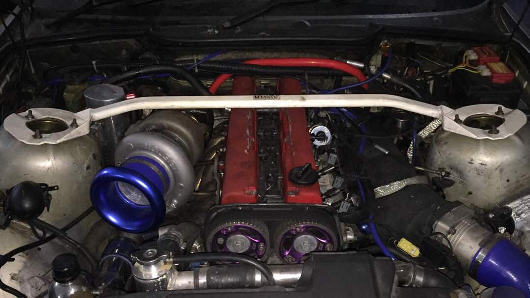

1jz E36 BMW frankensteining

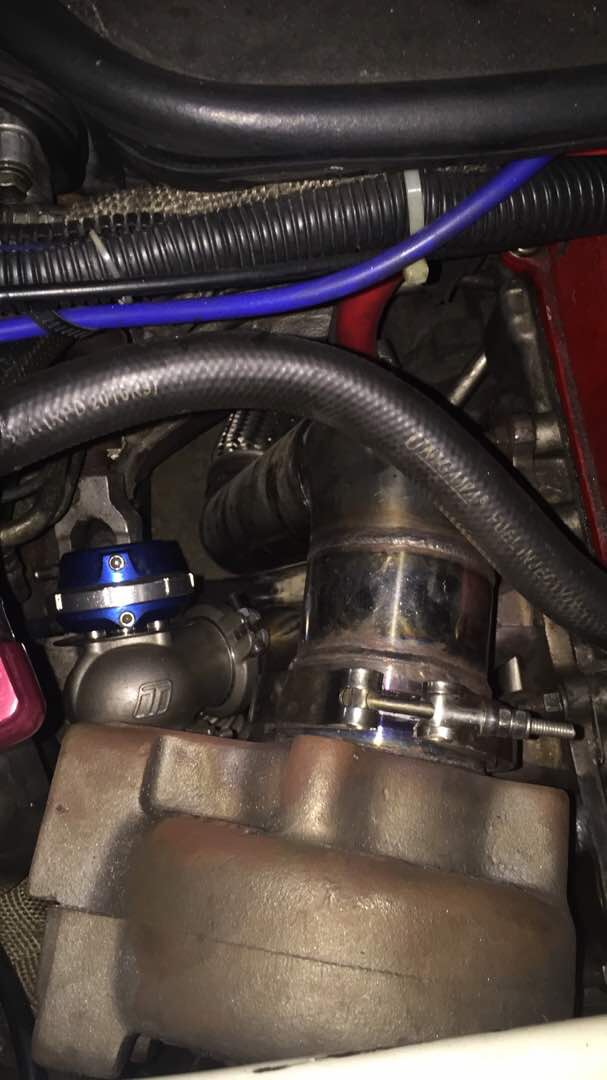

i suppose the red tube is rerouted water hose?
Anyway, out of curiousity, why go for turbosmart wastegate? it only come with 1bar spring right?

Cuz the dude helping with the build is also the distributor for TS products

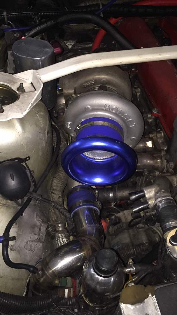

Latest update.
1. The turbo housing was replaced so the flange would fit nicely with the exhaust flange. So now I have a newly refurbished, previously refurbished Holset HX33 turbo.
2. Sharp eyes would notice a water hose being routed back to the front. So now I have a proper flowing coolant line going through the whole block.
3. The Turbosmart wastegate was found to be a imitation and was causing issues with holding boost. So had it changed out to an original one.

Turbosmart is a well known and established brand, the springs can be swapped out if required, and even if the springs are weaker than required, using a boost controller can bring the boost up until a threshold.
Yup i'm aware of the brand and its reputation. Last time during my quest in search for good wastegate, i chose tial over turbosmart because of the price slightly cheaper and come with various spring to set my wastegate. Both brand is reputable in motorsport.
yup, such critical parts better go for Ori.

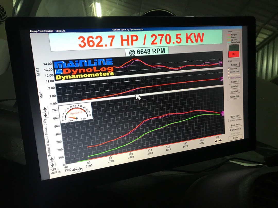

Car is finally done. Now just need fine tuning after testing the car for a bit and paint. Final Dyno is 1bar 362.7HP on mainline dyno with 280 foot pounds of torque. Not too bad.

lanciao laaaaa 362hp on MAINLINE DYNO samore weyh, that's like 4xxhp on a standard DynoJet
Personally, I just find dyno graphs just an indication of what needs work and what needs tweaking. At least now my boost is stable and everything is stable regardless of how many runs I go.
