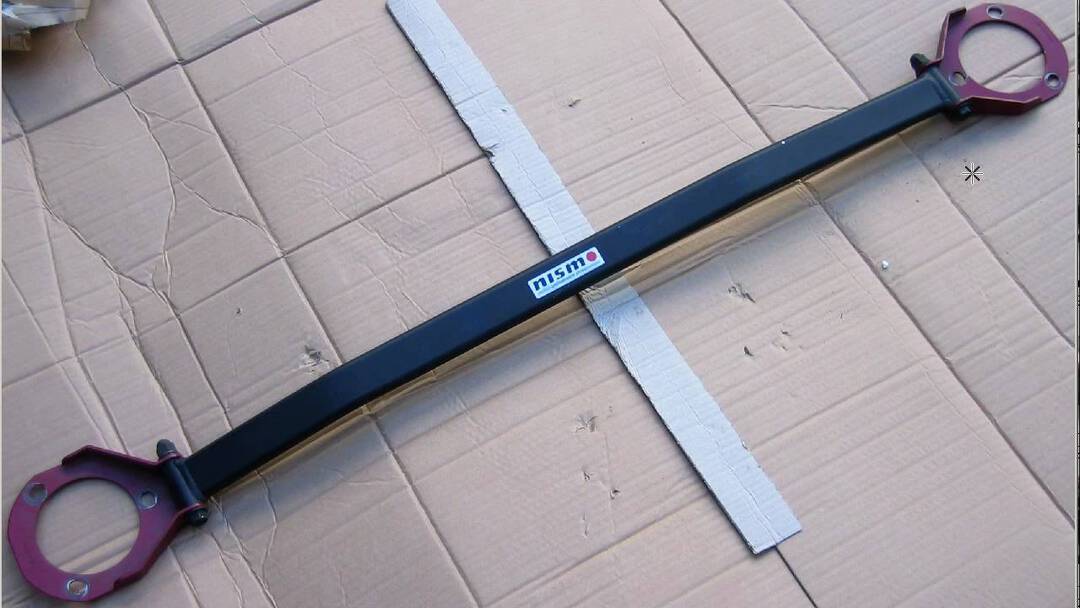

Simple search on mudah.my can see lots of merchandise for E46 coilovers, not E36 though. However, i found Zerone, Gear, Project S and other foreign brands that i never heard of. What's the coilover you are using ?
The Nismo strut bar came from a 350z, we need to fabricate the bracket, i only need the middle part, which the ends of it are locked by Allen key style screws. However still measuring the angle of the bracket so that we can achieve the roll efficiency. Otherwise i will use this for my Lancer as Lancer has more rooms to play. Below is the picture of it. The NISMO wording has to go.
didnt know izso already mentioned the benefits of DBW. i'd say, try to find a strutbar for bmw, kinda pointless and waste of money modifying this to fit. making bracket would set you back few hundreds bucks already.
I don't need to convince you. I'll just wait for you to go live with your current setup and then I'll wait for you to regret and wish you had done it whilst building... :biggrin:
Actually dunno why I'm grinning. I'm regretting like shit not doing it earlier when I had the budget.
I'm using Ftuned. They custom made everything according to my spec which is based on the bosses own e46 coupe.
Custom making a strut bar? That's madly interesting! And yes, the nismo has to go. HAHAHA
