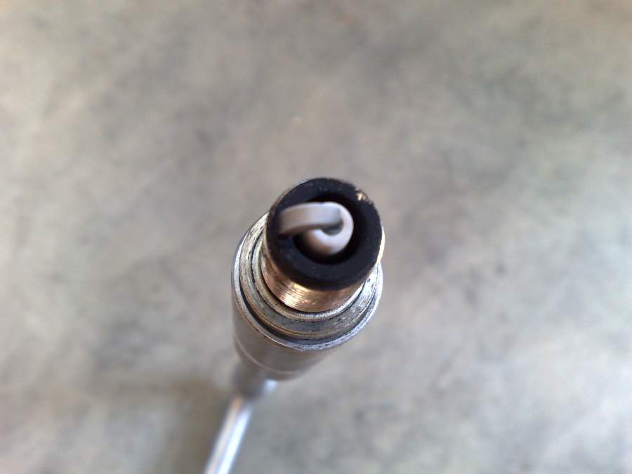

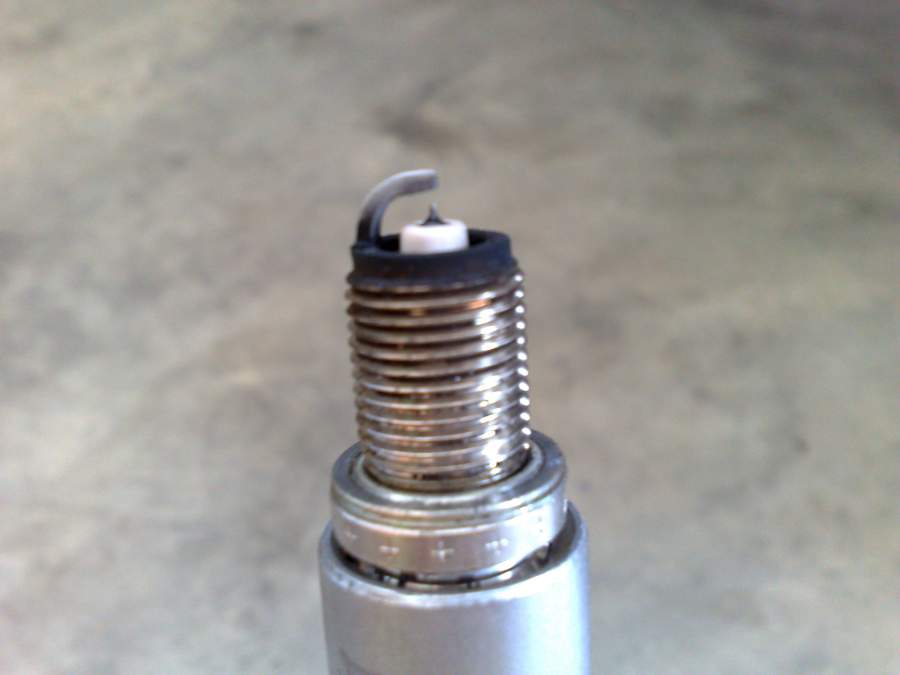

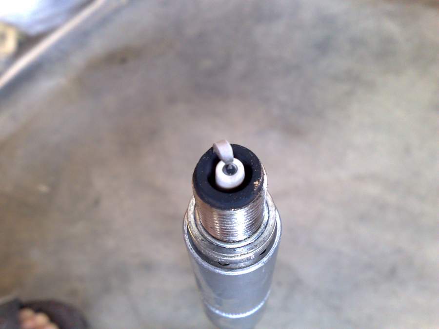

bro,im using ik20 in my svt.i found it abit dry n white colour,izit too lean?how to solve tis prob?thanks bro.
Bump: bro,im using ik20 in my svt.i found it abit dry n white colour,izit too lean?how to solve tis prob?thanks bro.
