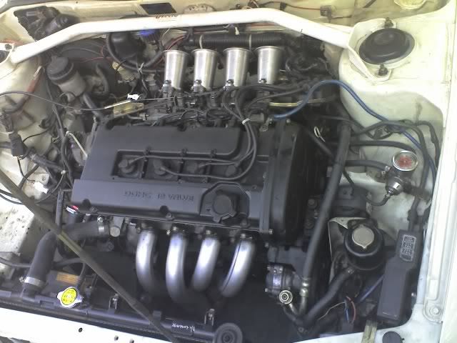

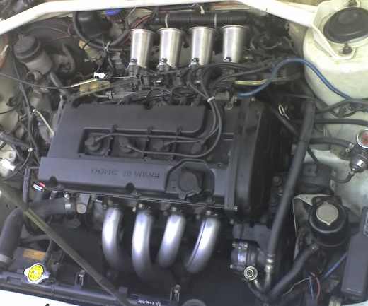

Leftfoot, so where is the ever illusive ACless engine bay pictures? Or is the AC back in already? Not cool la drive fast car but come out of car the back of your shirt wet .....:hmmmm:
Haha.. i never sweat!.. hahahaahahah. ever since the engine transplant I never used AC.. been 'training' my body to suit the warm heat. its not that bad la. i hardly sweat now...
pics
incase there are problems with the pics (which now is) heres a backup one..

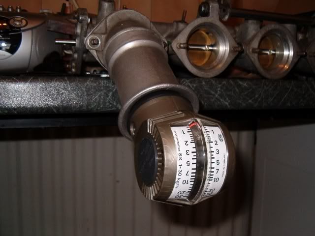

Check this out guys, its a sychrometer.. I wonder if i can get this locally. its about 40Usd, and 29usd in ebay. Can be used to balance my beloved itbs.
good shit u got there..no more use thumb to feel the air sucking..
if i were u i will buy..
im finding ways to build one,.. or mod anything to serve for that purpose. hmmm..

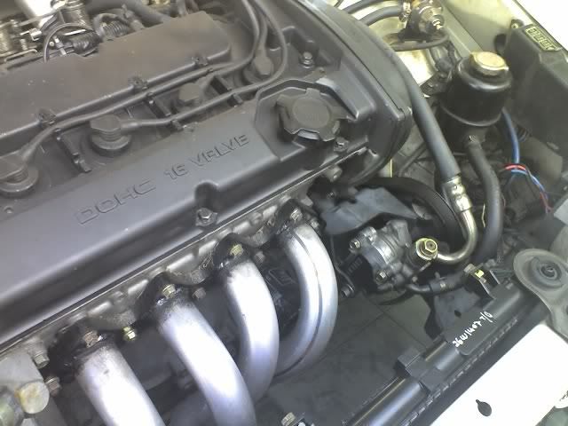

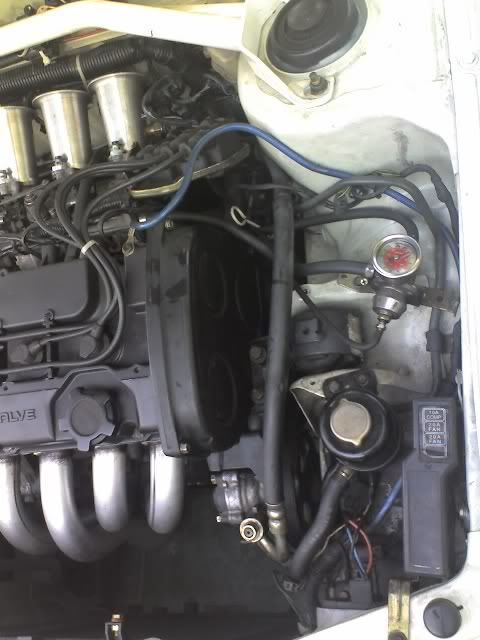

I have updates, but without pictures I felt it wasnt enuf for you guys. heheaha. Anyway, Just installed a custom made underdrive crank pulley yesterday and boy I could feel the low revs free now.
its made of aluminium, mere 1kg in weight (underdrive) means belts are now shorter. to be exact, I use 5pk 870 for the ps pump (no ac), and 4pk 715 for the alternator.
because of the lightness of the pulley, I no longer have bogged down idle whenever I turn the manual fan switch or turn up/down my power window.. hehehe
sorry no pics. told u will let u guys down. :) I'll take some today already installed, If I remember. no promises.
