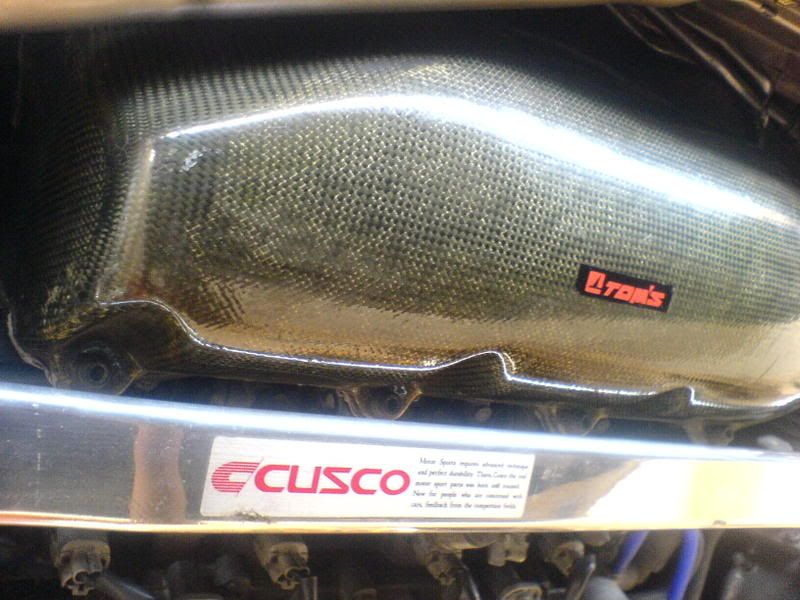

Btw, I tot the Tom's intake originally comes with Tom's trumpet, right?
Sadly no Tom's intake for BT. If custom made using CF for BT roughly how much would it cost? Stock plenum is too freakin heavy! :slug:
