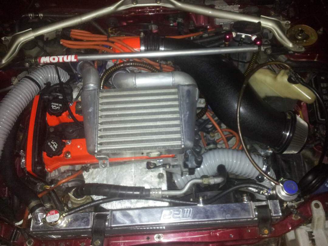

my car is running in large pully,nology,arc top mount tested but front mount still the best,blitz open port n plug n play hks pfc f con,
next going for sc93mm pully,port n polish big port head with na 250 cam,our sc stock 240 if not mistaken, hopping that can get 1,3 bar,previous now is running 1.0 bar ...

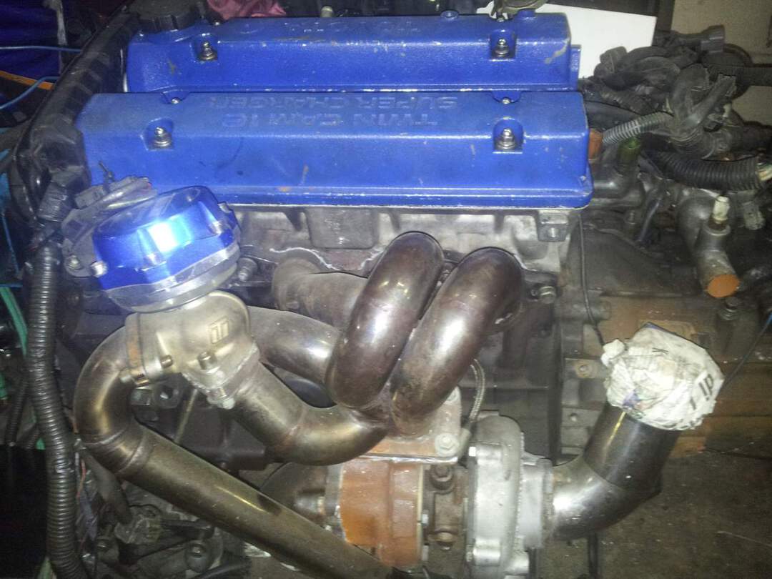

the orange is running with stock sc12,
bue is my future twin charger but might not gonna happen.
