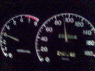

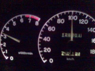

Hi Alvin.. I already tried using gb for 1.3, 1.5, 4g91 and 1.6..
At 3k rpm on gear 5, 1.3 gb oni reach 90km/h
1.5 gb oni reach 100km/h
4g91 gb reach 110kmh
1.6 gb reach 115kmh
Wat I feel, 1.3gb good for pickup but wanna reach top speed rpm will be over than 7k but fast.. scare.. worry about timing belt.. 1.6 gb good for top speed..

no lar... impossible.. 1.3, 1.5 and 4G91 gearbox same ratios... =Þ (if not mistaken, same gearbox code also).
1.6 a bit longer
1.3, 1.5 and 4G91 at 110km/h on 5th gear should be about 3.5k rpm... or somewhere just under.
i remmeber last time badguy's conversion also use back his 1.3gb...and 5th gear rpm3k somewhere juz below 100kmh...and my 1.5gb also the same
actually there are lots of ratio variation, I was informed that local F5M211 (1.3 & 1.5 GB) all using the same ratio, JDM ones could have variation.. F5M222 (1.6 &1.8) of local ones also all have same ratio, JDM have a lot of variation depending on generation
