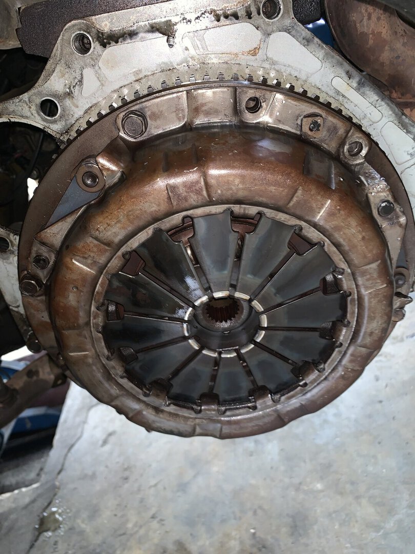

All started when I noticed puddles of oil where I parked. It wasn’t engine oil but gear oil, leakage was near the flywheel so had no choice but to drop the gearbox. As you can see..
supposed to be oil-free but it’s clearly wet

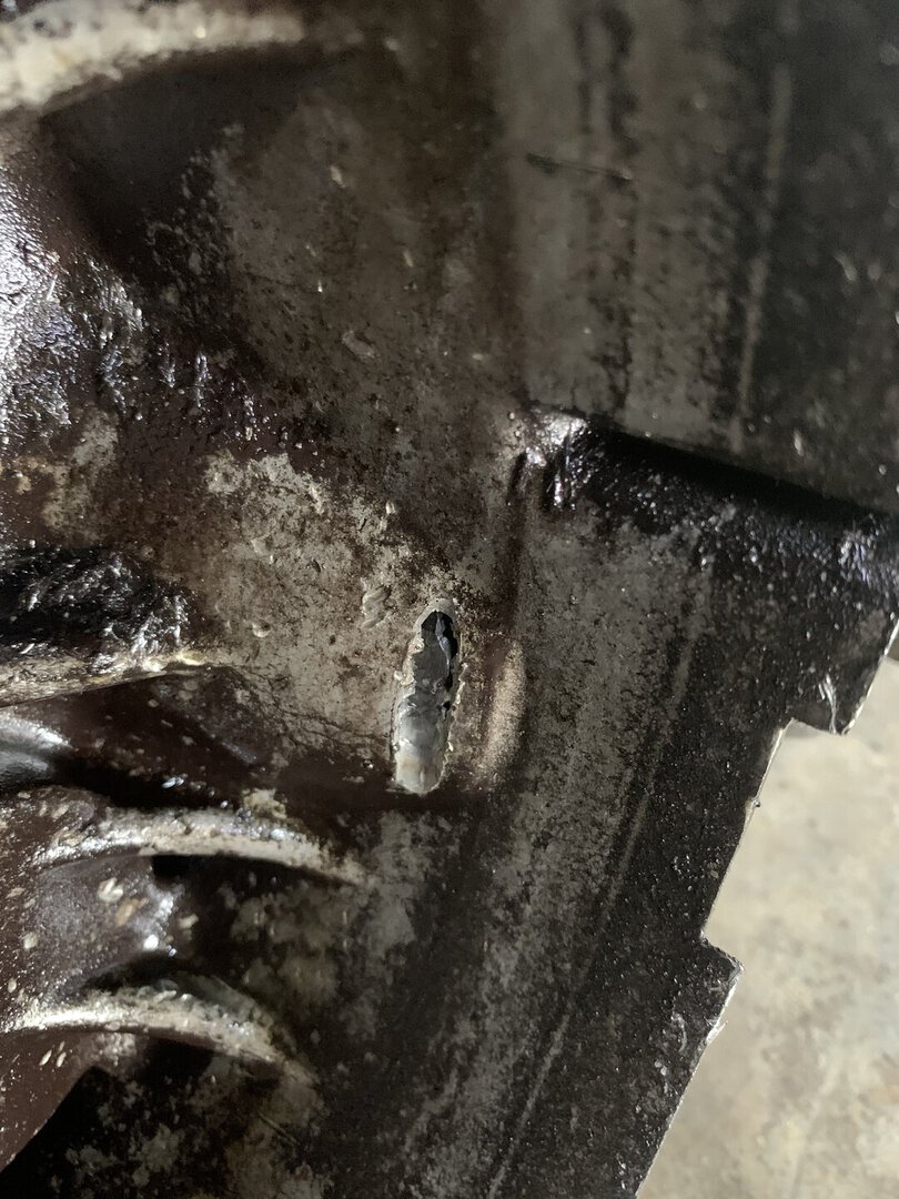

punctured housing, that’s where the leakage was from. Something must have broken!

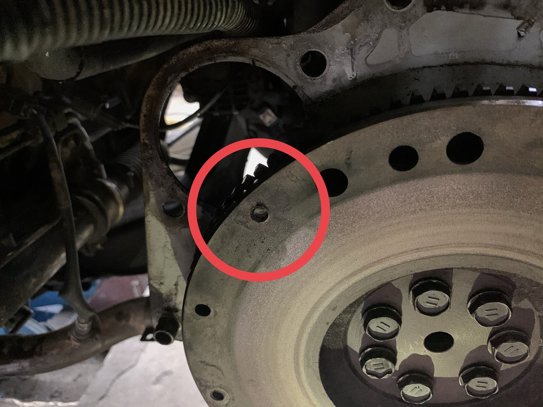

One of the flywheel nuts were broken, couldn’t find the fragment. With this, it has damaged more parts..

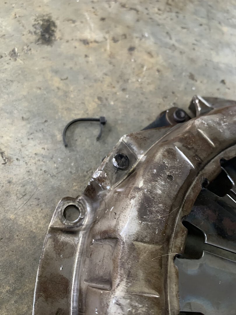

All edges of the clutch cover

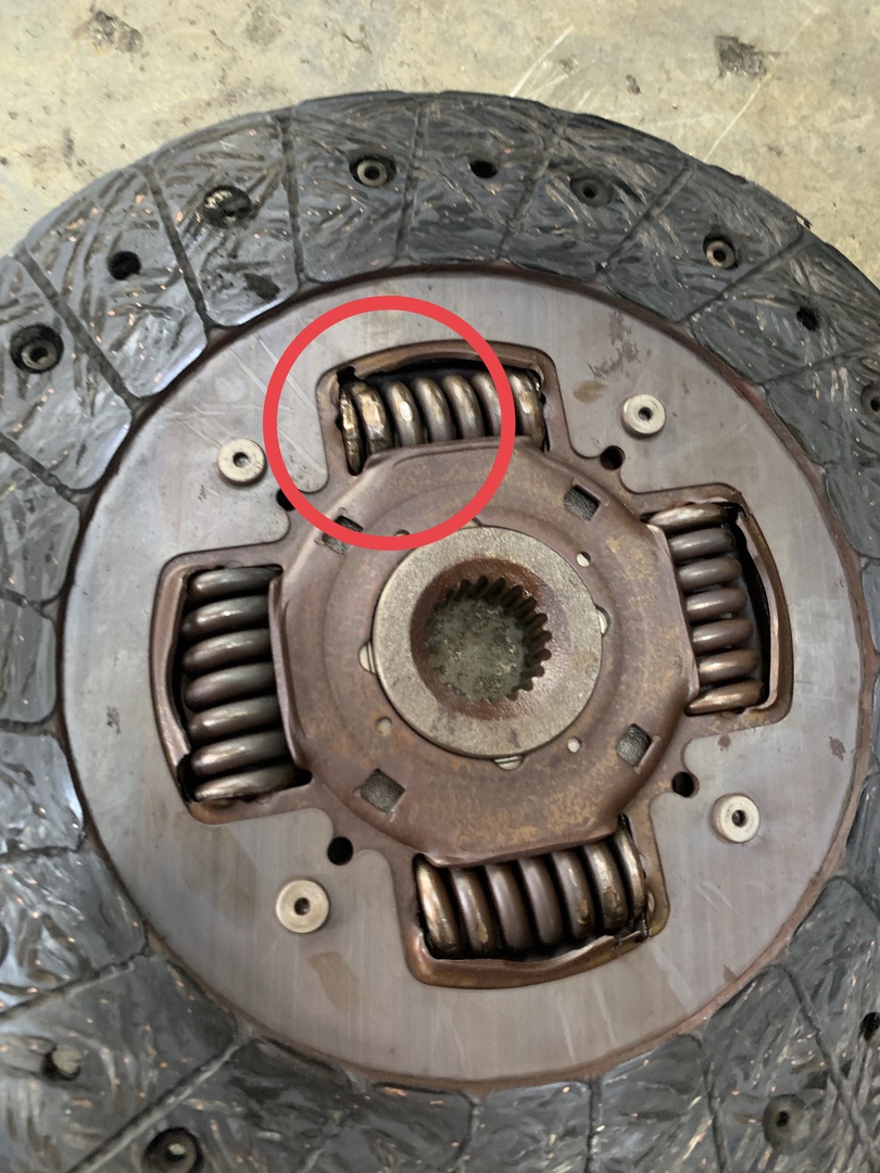

clutch springs have been hit
