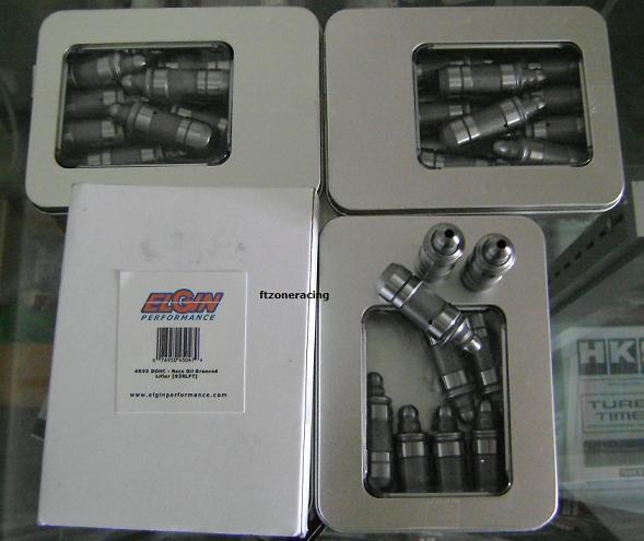

For those "fed up" with the stock lifters a.k.a tappets "ticking" noise.
I have a solution for you.
Brand New. Made in USA. ELGIN performance hydraulic lifters for the following applications is available now.
4G91 DOHC, 4G93 NA/TURBO DOHC, 6A12 V6 DOHC (V6 requires 24pcs)
Call me at 0164786000 for information.
