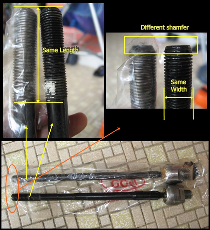

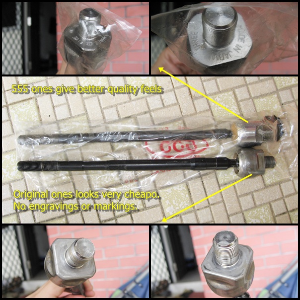

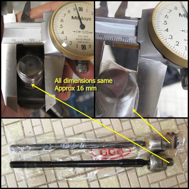

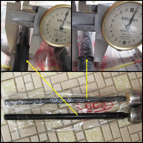

Ok... changed the rack end and yes... it is compatible for A32 and A33 rack end. But there are some differences on the cosmetic. Part # 485210C005 from 555.
