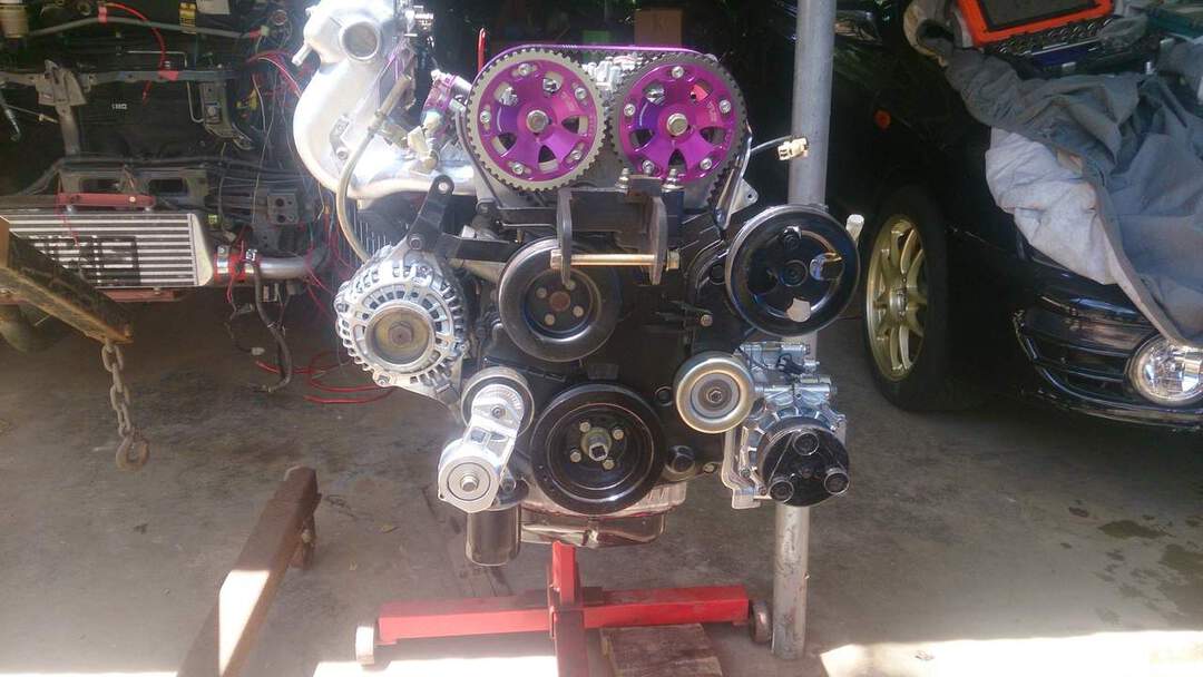

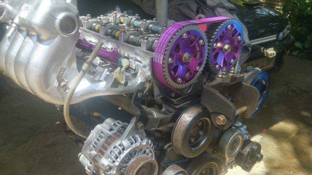

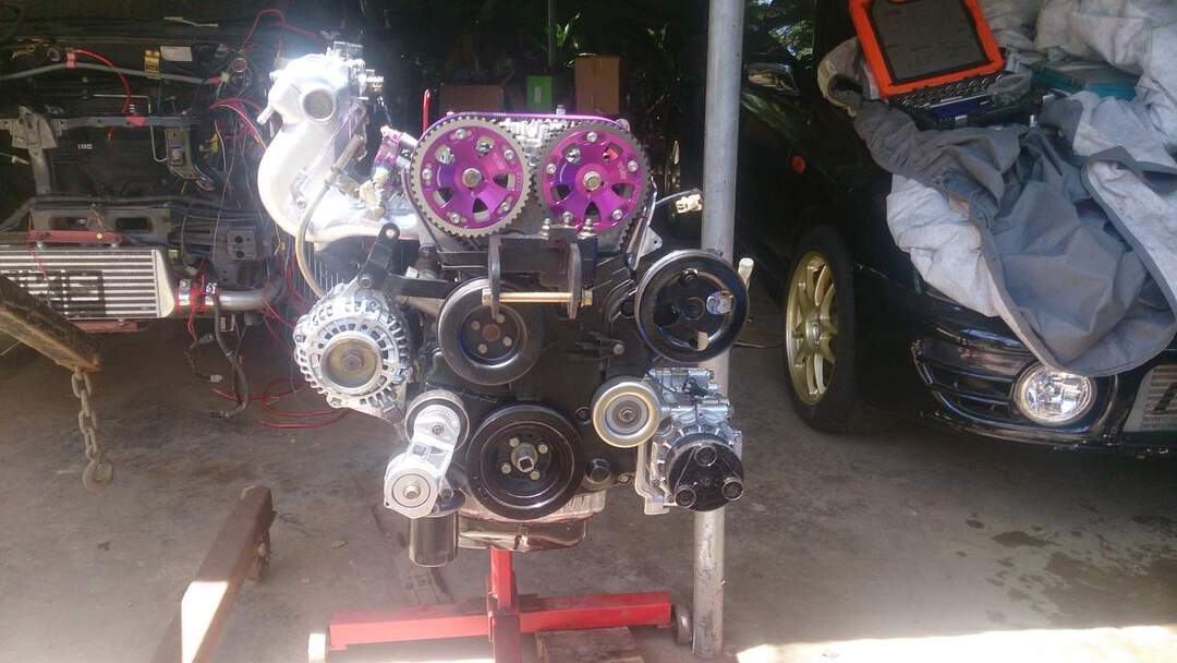

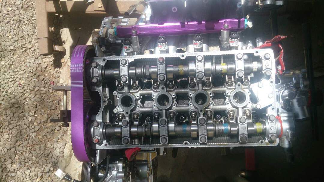

Hi Guys,
Pics of engine before install. Wiring almost completed. Should be starting in a few days.
Will keep updated and post more pics and vids.

based on all other parts u already had, u should have run with custom intake manifold and bigger TB to get better effect at high revs. 300hp is achievable with just td05hr and high lift cams alone..
if properly tune with all these hardware, u should be running at least 400hp.. but if u r targeting 500hp, u got to have forged internals.
