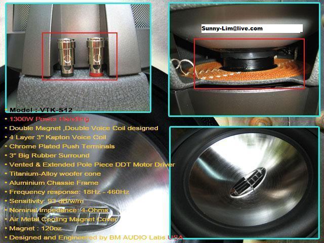

i found few amp,
all sifu, pls help me. as i wan to push my boschmann 12' 1300W(650WRMS) SUBWOOFER.
sub is 4ohm DVC.
so, if i use monoblock amp, how abt the wiring diagram?
bridged it as , 1pair speaker wire to the speaker only ? connect both speaker terminal ?
if using 2channel , connect both channel to the speaker ? load it as 4ohm ?
i mean 1channel to 1 speaker terminal +/- .
can be done like tht ?

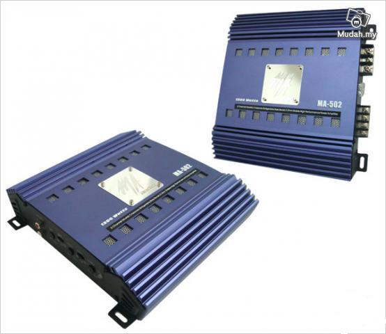

so , abt the MA-AUDIO AMP, it can be run at 1200w bridged x1 at 4ohm oh.
so , got 600rms lo . at 1channel bridged. right ?
i list down the amp spec:
(blue color)
1.
MA AUDIO MA-502 300W RMS 2CHANNEL HIGH PERFORMANCE AMPLIFIER 1200WATTS
-:Item 100% Genuine, High Quality, Brand New Sealed In Box
-:600W x 2 output at 4 ohm
-:1200W x 1 bridged output at 4 ohm
-:Full mosfet power supply
-:2 ohm stable stereo
-:Frequency response: 10Hz - 30 KHz
-:Selectable bass boost (6dB, 0dB, 12dB) at 40Hz
-:Variable input level gain control
-:Chrome plated RCA connectors and terminals
-:S/N ratio :> 95dB
-:T.H.D :< 0.05%
-:Full selectable crossover: High/flat/low
-:Variable low pass filter: 50-250Hz
-:Variable high pass filter: 50-250Hz
-:Power & protection led indicator

sub is dvc 4 ohm 650W rms
u need an amp that can give at least 600W rms at 2ohm (your sub has to be wired in parallel)
parallel wiring diagram here:
http://www.the12volt.com/12voltimages/1_4ohm_dvc_2ohm.gif
not all 2ch amps cant go down to 2ohm in bridged mono mode
look for monoblock that can give at least 300W @ 4ohm or 600W @ 2ohm
