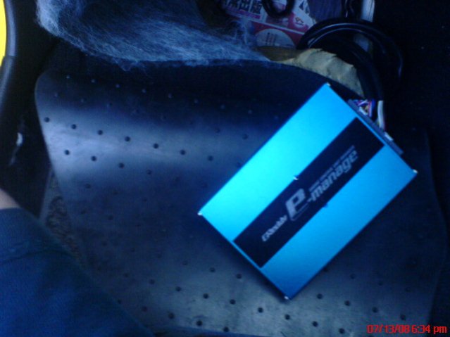

safc, std 4g63T evo3, tuned by joshua of millennium, 270whp @ 1bar. takde ignition tuning pun kuat ape.. it all depends on the tuner, in my opinion lah kan
attachment.php
