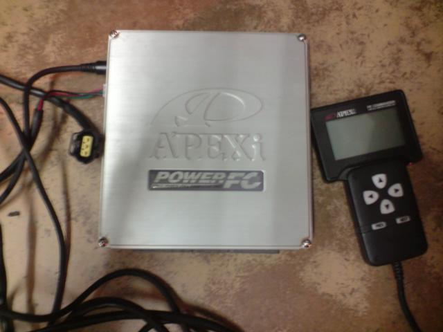

Hi,need help from sifu here.
My fren got 1 power fc take from japan by his fren.n he oledi check all socket is for mitsubishi.
1)can it pnp to his 4g63?(but he told me his engine not evo model,is rvr model)
2)if cant pnp,after install it n do some tuning then ok right?how much for tuning tis?
3)socket(yellow colour) at left hand side is wat for?
Thanks for ur time,sifu
power fc will have code will tell you what car it used for
just see the code and you will know it for what car
I heard N1,Kamal,GT and JC Racing can tune Power FC.But not confirm the cost for tuning on dyno.
JC Racing RM500 to RM600 for tuning and dyno fees on almost stock engine...
Thanks all bro,let say the code is for mitsubishi,then all mitsubishi car can use it?
if the code not for mitsubishi,then it is useless for my fren?
Thanks again bro
yes, most Power FC is pnp (plug and play) to the car (they make specific harness / plug) for the car ECU.
HOWEVER, I have one my guy done a Honda Power FC into a freaking SkylineR33 before. It's doable. So, suggestion is for you to find out the part # of the Powe FC (usually goes like 414-M904) then decide what you need to do. What year/spec is your car ?

Bro,my fren cant found any code like 414-M904,but he found PFC SW20 A0013,is it for Toyota MR2?his car is perdana with RVR N23W 4g63.thanks

Bro,how to differentiate wat type is it?my fren got 1 is for toyota 3sgte,can mod it to use it to mitsubishi 4g63 or toyota 4age?thanks
