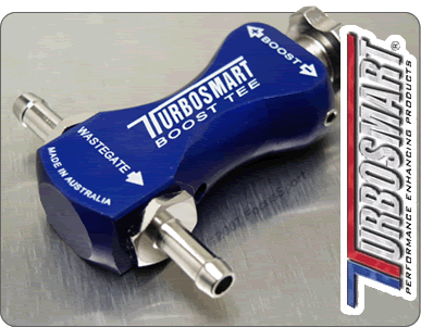

not T boost bro~ is turbosmart boost tee, is very good item,if u cannot boost up your turbo,please install this one part is very use full and work can support 40psi and long life,![]()
wow !! Thanks ! Chriss !!
Thanks your picture :wavey:
This Tee Boost put at engine bay also ?? Hehe...
So far seldom saw this item... I just saw a lot people using electric boost controller
If u understand how a boost controller works, u can place it anywhere u like bro...

EBC xpensiv ma...those T much cheaper
Not only that bro... This boost T boost up faster than EBC. At least I know it is faster than Greddy Profec B. Tested.
