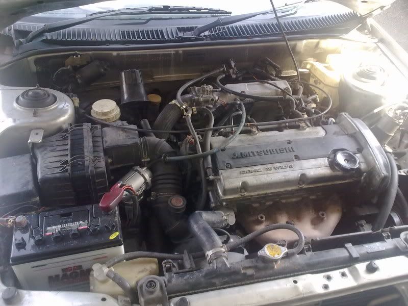

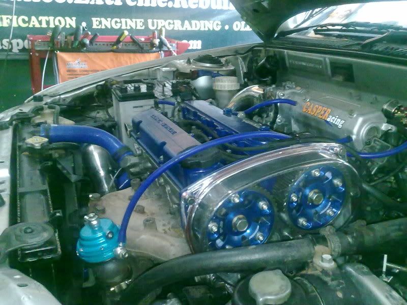

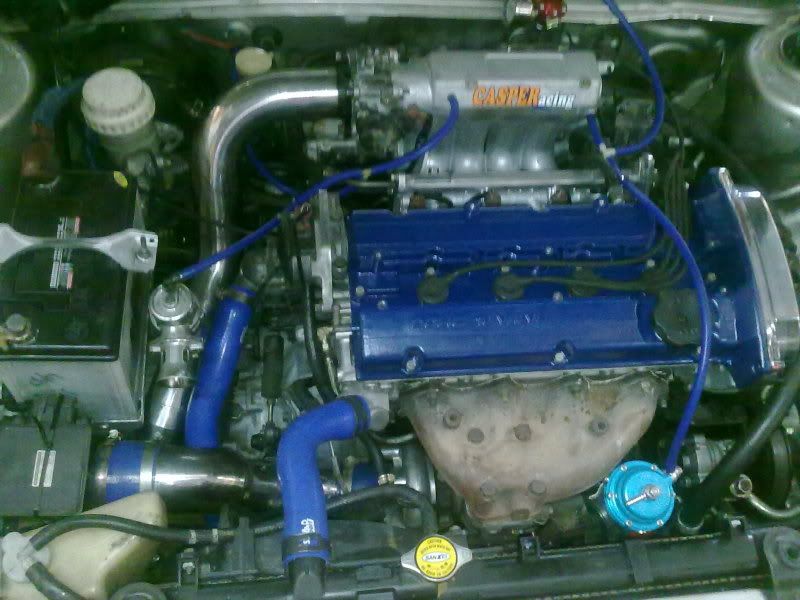

Hello bro,i have experienced the prob like u b4.Mine also 4g93dohc BOT and I just completed rebuilt my 4g93 BOT.B4 this mine BOT very unsastified,lack of power,rojak wiring.I decided to rebuilt my BOT.OK, I show u the picture before and after....
BEFORE
AFTER
My mech at Puchong,For me he done really nice job.Now after rebuilt,i can feel very difference in term of power,respond and also nice engine bay.If u interested,just pm me...

Wah!!! nice set up wo. Complete new ss pipiping, adj cam pulley, radiator hose n WIRE TUCKING. My foreman don't wanna do it for me... He say if anything happens to the wiring, he call me to find other ws to settle it. Sienz...

Actually that wiring took from other gsr..So when put it inside mine,must also do like that.Just a standard setup.Only add with fpr,w.gate,adjustable cam pulley and remap ecu.Turbo still using td04l.Before this my BOT give me a headache especially on wiring site.Also got no power.But now really different.I cant use standard exedy cluth cause slip giler giler when full boost.So i changed to trinity cluth.
