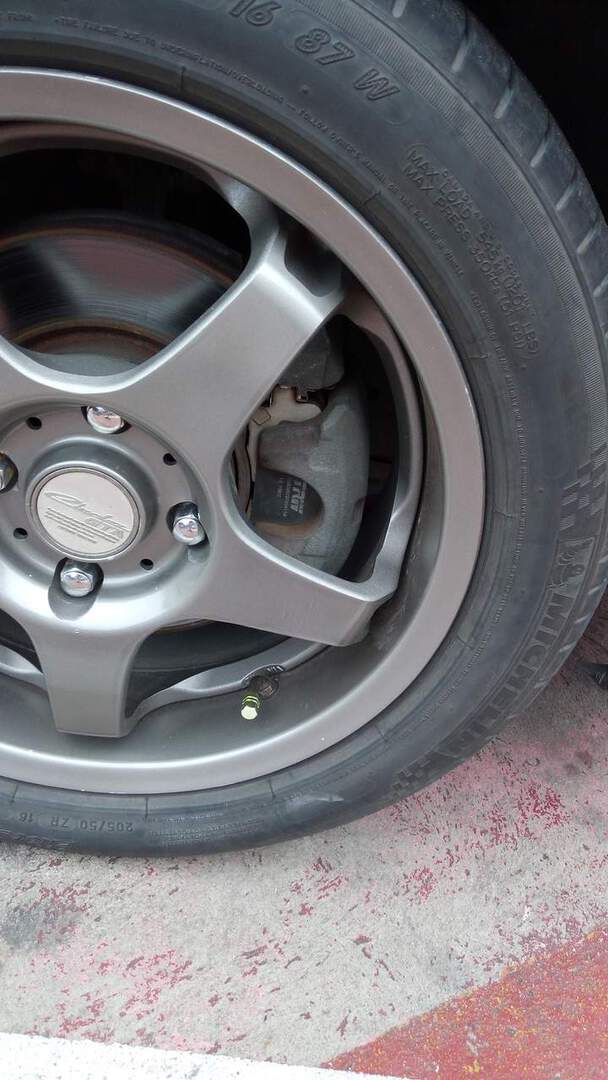

Since my Lancer Engine swap I feel I should do a brake upgrade.
I am lucky that my lancer already has fairly good brakes, with rear disks but I now have about 60% more BHP.
On the back I think I can just put upgraded brake pads but I would like to go bigger on the front.

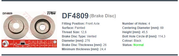

Current standard set up is 276 MM vented as per here:
attachment.php
I am running 16 inch wheels (which I would like to keep), although the stock wheels were 15 inch, there is still not much clearance on the stock single piston brake calipers:
attachment.php
attachment.php
attachment.php
I take it if I went for different calipers such as 4 pots (maybe from a skyline R32) or 2 pots (maybe from a FTO or Spacewagon, would I have more clearance?
Has anyone done a similar upgrade and what did you do?

If you used 4 pots, you'd probably have smaller clearance but still ok as long as there is still clearance.
why not just get a twin pot caliper from an evo instead of going 4 pots? :driver:

Yes agree, should be enough just using 2 pot calipers from Evo I-III. But of course if can afford 4 pot and can fit then no harm either.

Evo 1-3. I think evo 4 also use 2 pot. Rotor should clear nicely on your 16"

I've had experience with the R32 Skyline 4-pot. It's not a problem to fit a 16" rim, the problem is your offset. 40 offset won't clear it. I used a 5mm spacer to give it some breathing space (too damn close if you ask me) on a 17" rim.
Personally I wouldn't go to the R32 route because the oil reservoir inside this caliper is large, it'll affect your braking pedal feel, probably will drop a significant amount. I ended up not using it on my Sylphy because it was hard to modulate the pedal feel and it kinda gave me on-off brakes. I was using stock Nissan Sylphy servo. Unless you plan to swap out your servo as well? Master cylinder / Brake pump / whatever you call it.

Thanks for the feedback, there are a few guys in Thailand running the R32 skyline 4-pot setup, but I have no desire to change my master cylinder, especially because the hydraulic's on my car are linked to the clutch operation also so messing with this could create more issues. I think many just do it to get the 4 pot look on a budget.
I am looking to improve performance and feel (over looks), so thanks to your advise I will forget this idea.
Will probably look at costing out the different Mitsu 2 pot set ups, unless I can find a really good deal on aftermarket or Evo 5+ brembo 4 pots. (@samngcheesan I will PM you nearer the time I am ready to move forward, I am in Thailand but visit KL sometimes)
4 pots might be overkill for what I need though, I guess I am running now about 160 BHP +/- so less that an Evo 3/4 with similar weight. Even if I boost or mod my 4G92 Mivec more I won't be looking for big power much more, the concept of my car is to make it a fun car to drive within the limits of the roads in Thailand, not a power monster (if I had wanted that I would have saved a little more and swapped to a 4G63 Turbo).
