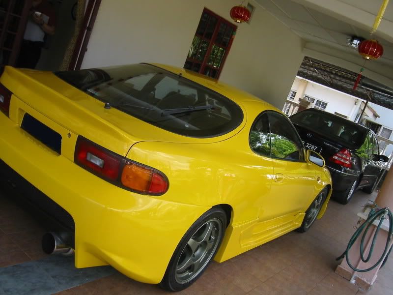

Latest Update (HOMETOWN FOR Chinese New Year)
yeah man... it looks better this way then black hood.. XD
Nice Celica ST model in yellow color. I like it. expecially the twin powerfull look exhaust. :biggrin:
---------- Post added at 09:55 AM ---------- 6 hour anti-bump limit - Previous post was at 09:50 AM ----------
Some suggestion for your reference:idea:, may be u can warp with the 3M 3D carbon sticker since there is carbon fiber look for your bonnet:top:. But it cost more higher than spray lah... hi hi hi...
dun wan lah... i like my car have supercar look like... got some fren say that my car looks like some old Ferrari..XD

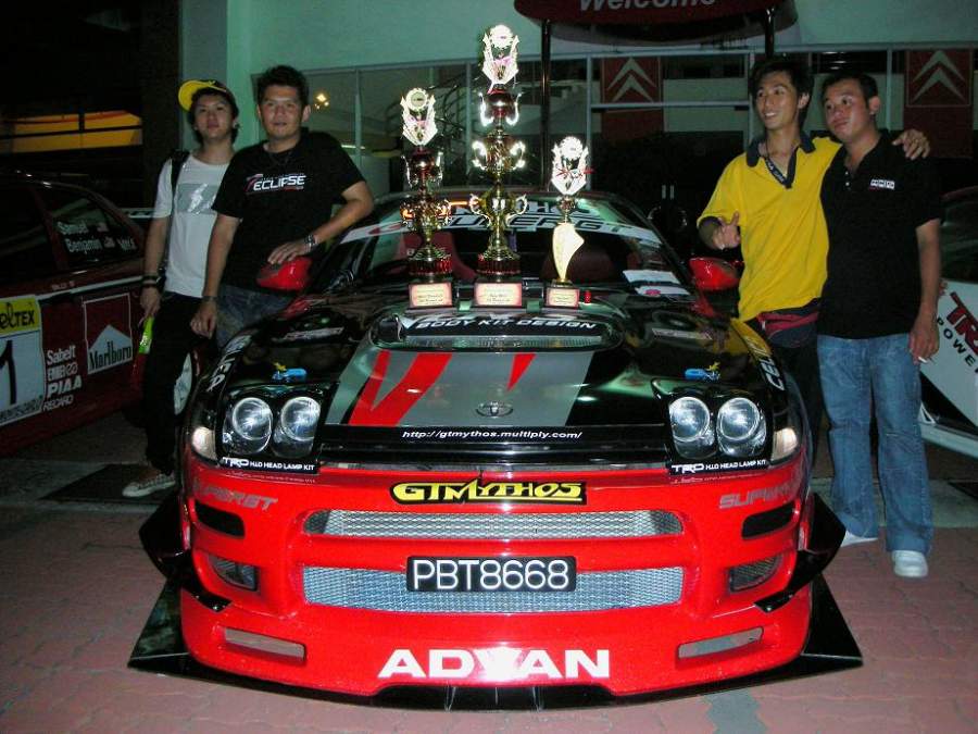

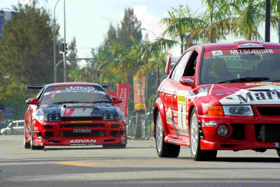

Bro Zeus, my ride as below...hi hi hi:rock:
Celica ST183 Year 1991.
Base Color : Red
Bodykit : Custom Super GT Spec + Full Body Sticker Decal
Modification :
Engine : 3S-GTE (3rd Gen from ST205 -- 255ps)
Transmission : Manual 5 speed + 4WD (Conversion)
Other Upgrade :
Engine :
Front mount Intercooler + Full Stainless Steel 3" piping + Samco hose,
Blitz BOV & Air Filter, Fuel Regulator, TRD Racing Clutch....etc

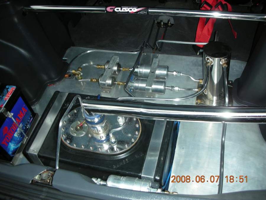

Fuel System:
ATL Racing fuel cell + BOSCH External Fuel pump + custom sugar tank.
Engine Management:
Standard ECU + Apexi AVCR, Apexi AFC, Apexi ITC.
Suspension :
Tein HA Adjustable
Brake System:
Replace with ST205 4pot Frt & 2pot Rear + Endless Brake Pad.
Rim & Tyres :
Volk Racing Rim 17" X 8.0j (F) & 17" X 9.0J (R) + 45/225/ZR17(F) & 40/245/ZR17(R)

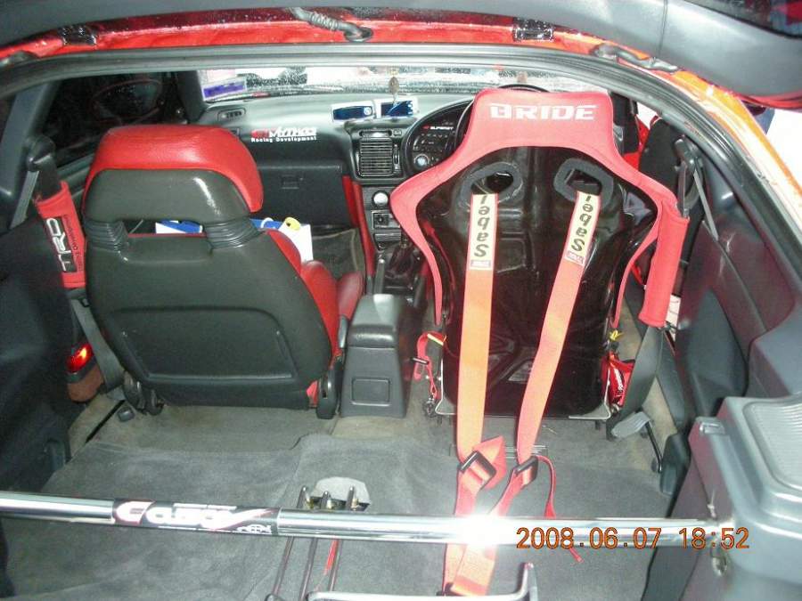

Cockpit :
Bride Full Bucket + Sabelt 4 point Hardness, SARD Boost Meter, ATL Fuel Meter, Pivot
Engine Starter, Sparco steering ..
Modification Objective :
To built a Super GT Looks Machine with real performance which
able on road even on track...:biggrin::biggrin::biggrin:
