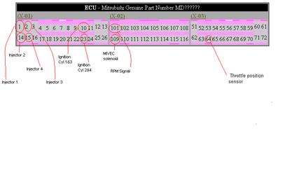

Hi Cipan,
I hav similar problem at my 1.8mivec, check light appear during idling. Error code is #41 injector.
All the injector connection was checked, no problem.
What other thing can coz it going wrong.
Pls advise. Thanks....
