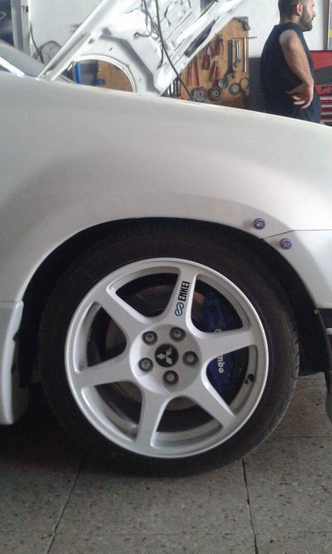

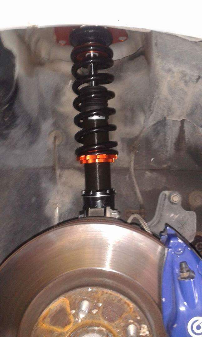

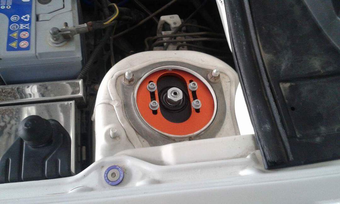

Well finally got around to fitting some k sport coilovers for the airtrek and they are very very good took about 2hrs to fit and set up.. had to adjust the camber and reset the tracking dropped the car 50mm all round and tested on the road and it made a huge difference it is all about the set up i got some very good advice of a time attack champion.. overall very happy with this product:driver:

Very nice! Can I ask what brake calipers are you using? From evo?
Sent from my Nexus 5 using Tapatalk
Yes front brakes are evo .brembo but you need to change the hubs and drive shafts to fit them the right way :driver:
