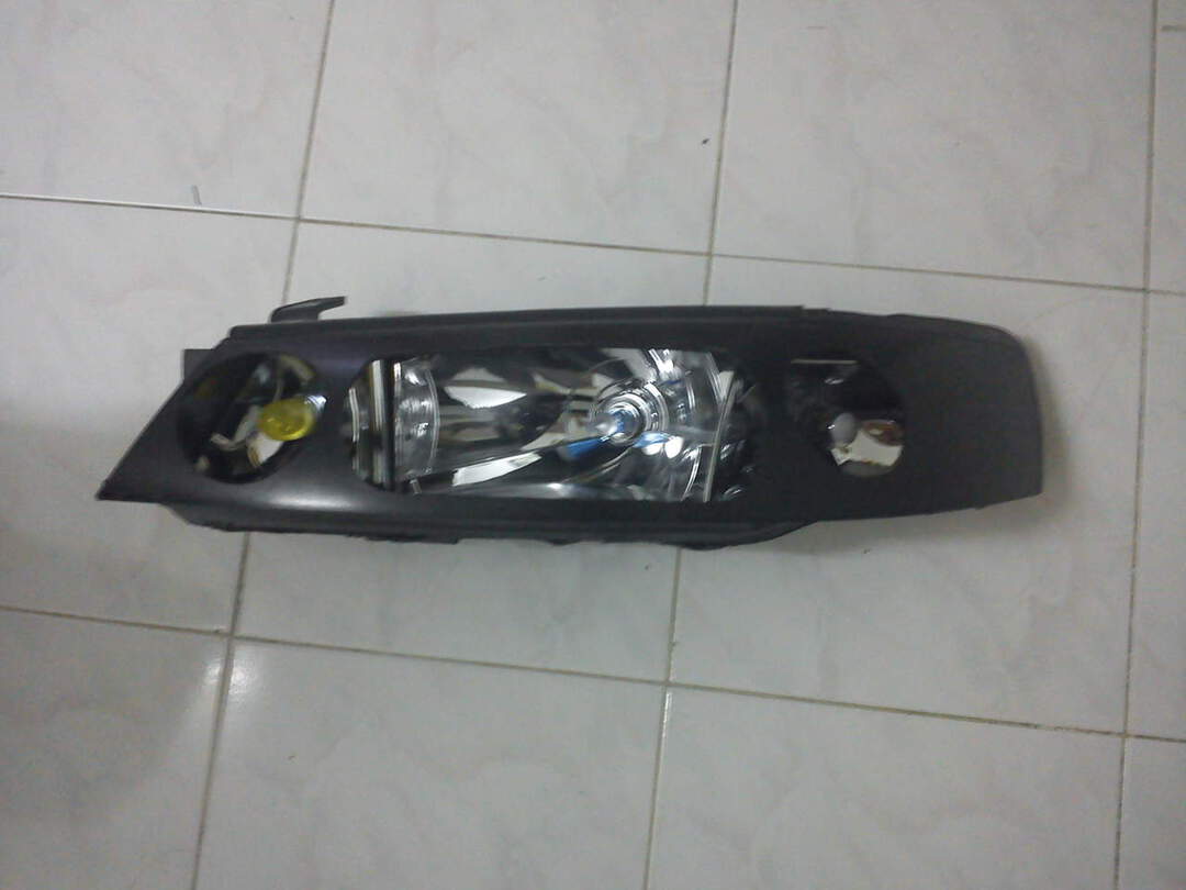

hahaha.. sorry guyz..
i got a little carried away.. and look what happens to my headlights..
it's not finish yet.. i got to buy a clear plastic & seal it b4 i can put it on my car

Thanx..
i'll post more pics after i done everything..
