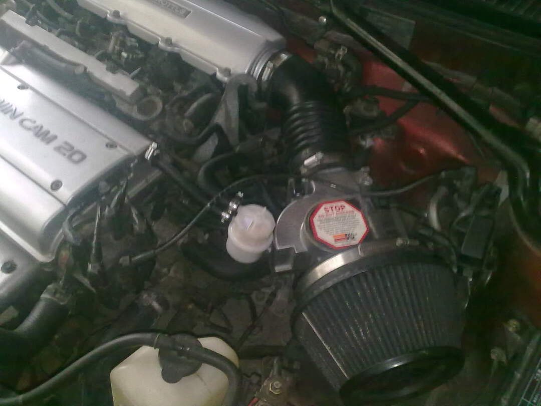

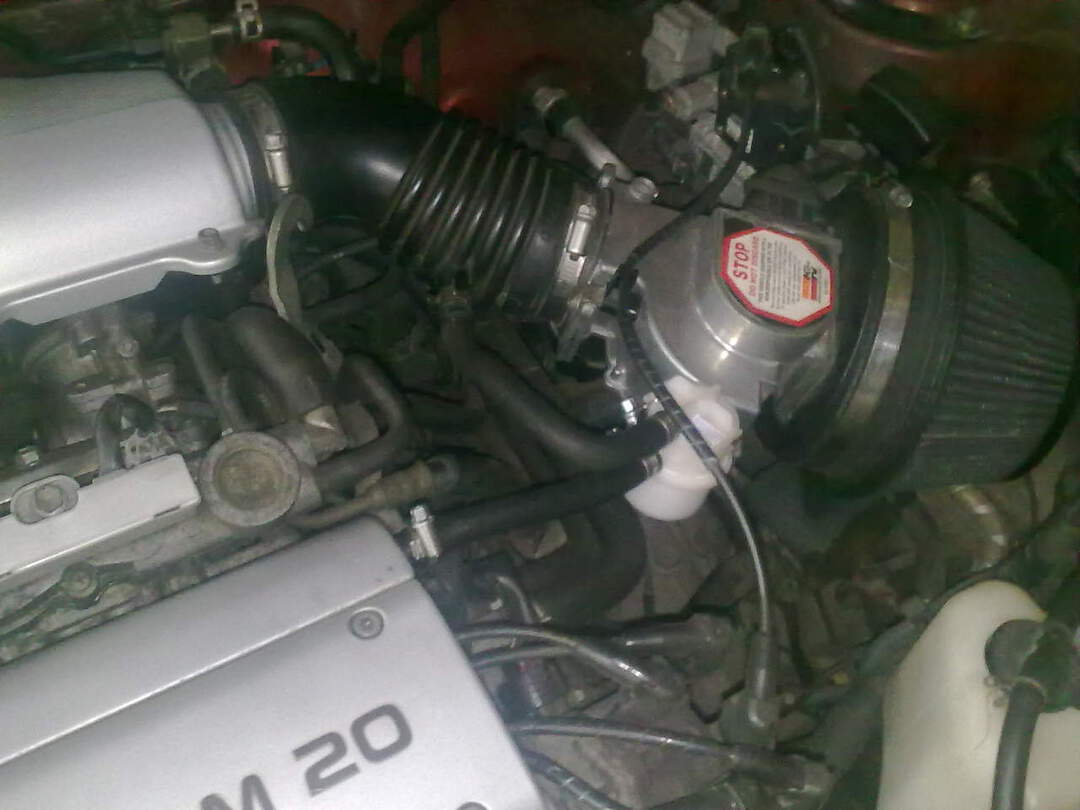

hi bro zul,
i had been finish install based on ur information given. please make a comment with it:biggrin::biggrin::biggrin::biggrin:
attachment photo

Take a couple of pictures of the engine bay with different angles. Maybe we can see from the pictures

Just for the record, I just discovered I connected the OCT to the wrong hose. I used the breather hose instead of the PCV!
(This is a Myvi btw)
So if anyone is doing this for their Myvi, please stay tuned. I will make corrections and post up followup pictures soon
