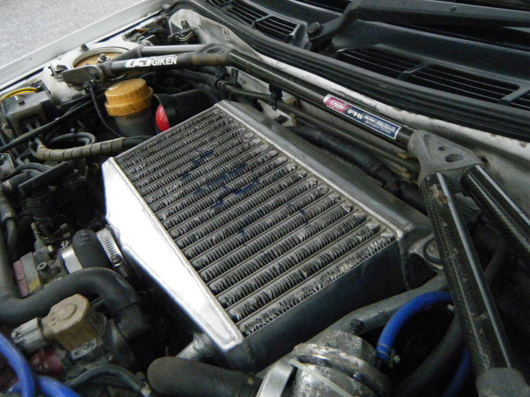

Like this one here... Decoration or CF?

Real CF are really expensive woh!....
This one I'm not sure. The one at pic is friend's father's car. He claimed his dad opened halfcut shop business but I'm not sure how true is that because he seems to be rather secretive when he talks about his father. Maybe get from halfcut...

But not commonly seen selling wor. Maybe that was custom? Or maybe imported from over the seas.
Full CF bars on one car I think can cost close to a Viva adi? :stoned:

No CF but still got aluminium. But how does that fare compared to steel?
That STI bar is probably from Japan I guess. It was written on the sticker FHI Fuji Heavy Industries. Aero Space Division.
I think steel no matter still harder than aluminum? Logically la. Ya, just reached more than 110km/h on mousedeer again lol just when reach 100km/h if step gradually will climb slower more than that.
Which is why I think those CF bars have to import from over the seas then. Even TRD Strut bars not easy to find for my car. Wing Hin only have cars that is popular for mods. Such as the current FT86

the CF strut bar is exclusive for Subaru STI model...it was very light....but regarding the stiffness still more or less similar as the subaru aluminium bar....
if compared to proper tough steel like UR bar...because due to rigid design UR bar should fared better...
