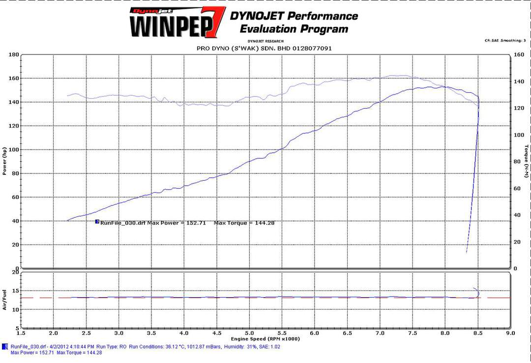

okok le... just stock with knn open pod, walbro and exedy 4 puck :biggrin:
