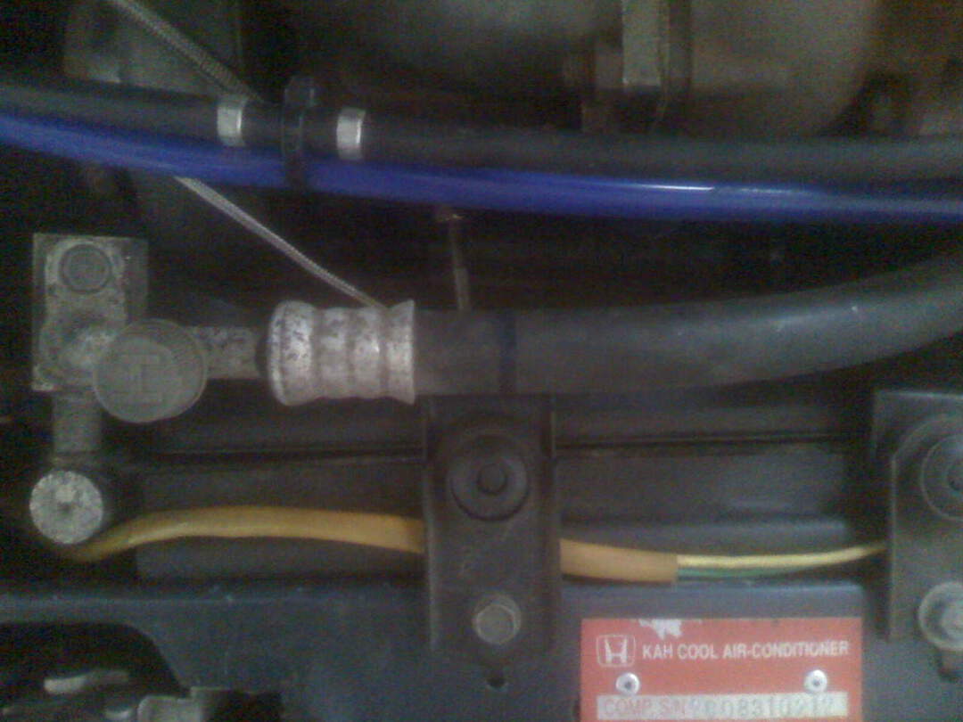

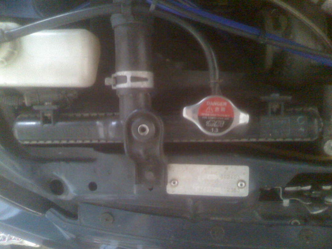

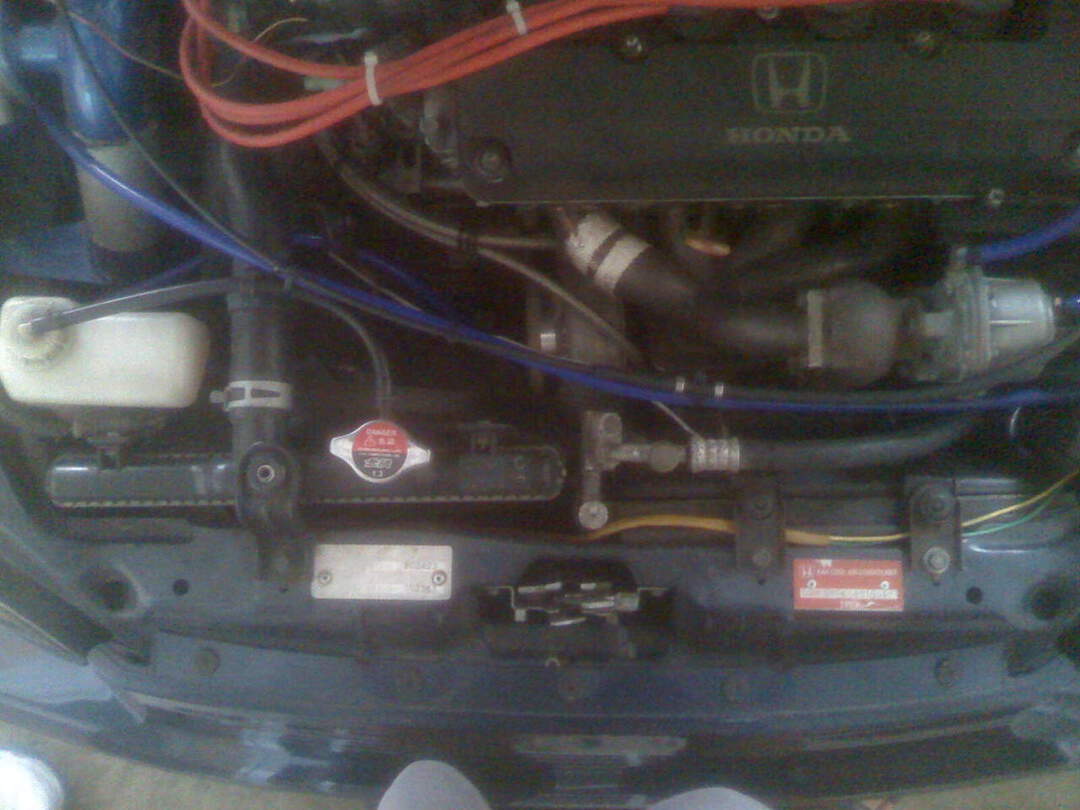

for madman
both can me use, but, the place near the head lamp, the "tip" where the bonnet meet with ur bumper, 4 doors are wider..... but if u use eg6 bumper, then no issue....
