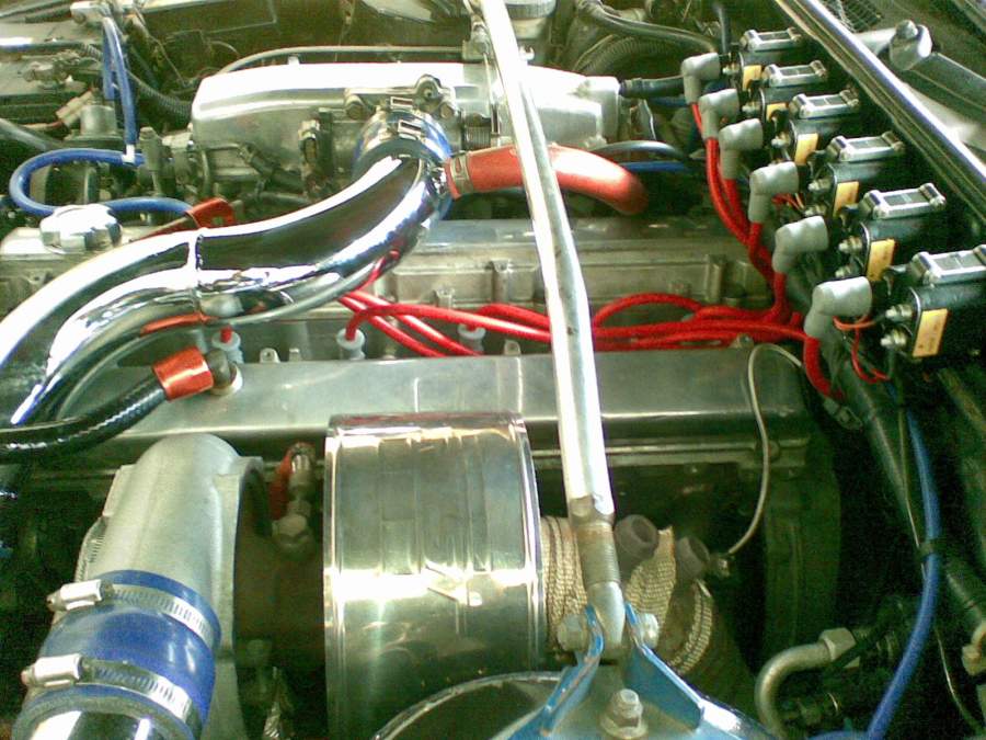

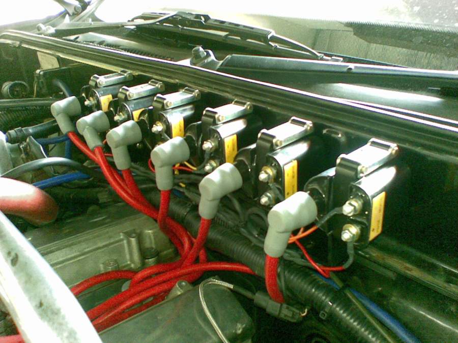

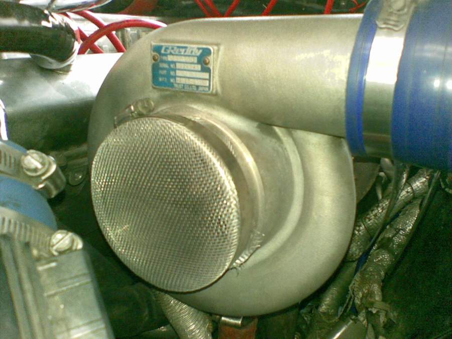

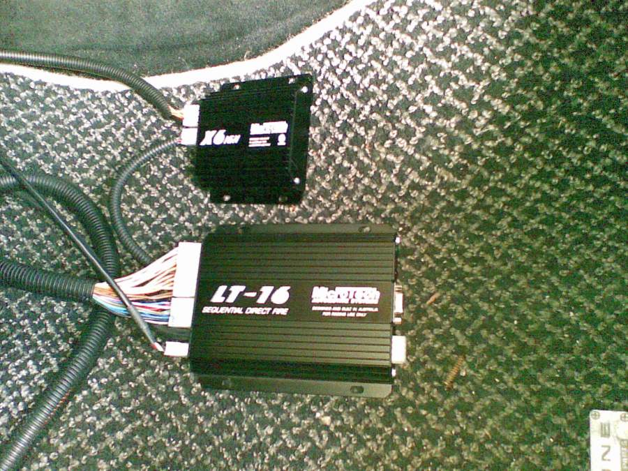

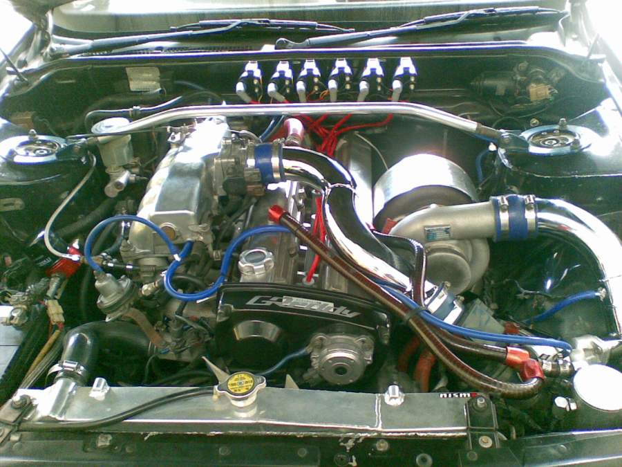

Just finist wire up the LT16 for RB25DET.And the sound of engine like a tiger(joke)hahhaha.Today im going to the dyno tuning.Wait and see what Hp power come out from the engine.Stock boost before have a 321hp.Im try to push a same boost to 360whp and after that 450whp may be.

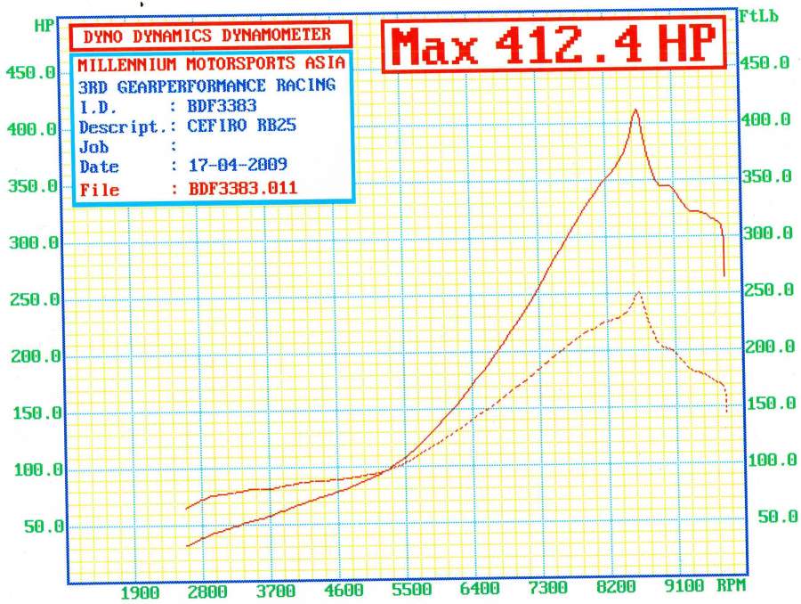

Bump: From a little bit changing Fuel and ignition timing,i have a small number whp.Before it's 321whp at 1bar boost,today with a same boost again get 412.4whp and 250ft Torque.Try to up the boost but the fuel pressure drop.May be the problem come from Fuel pump or Regulator.I will be back for dyno again after everyting done.

Interesting dyno charts. Who is the tuner anyway? Is he local?Sorry guys i'm new here.

Syahz, brilliant dyno results for cefi Rb25, good job bro.
p/s: mayb his fuel regulator not ori fse but fcuk hehehe:biggrin:.
