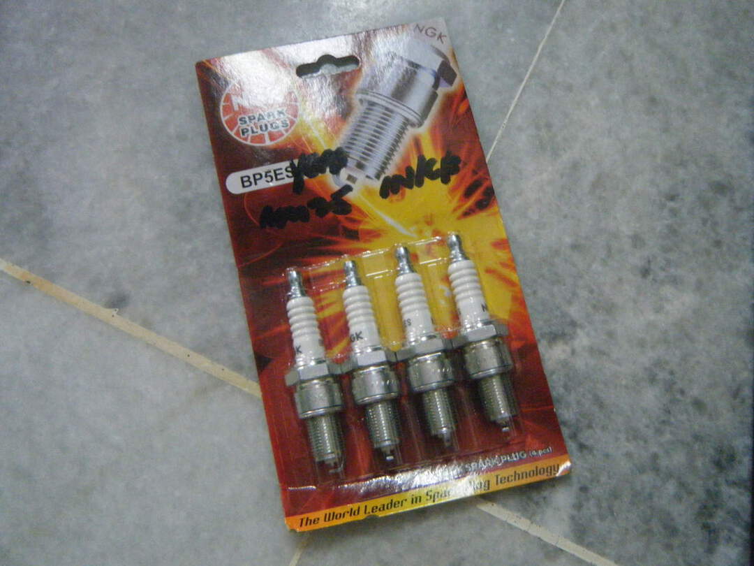

I'm using NGK spark plugs. Ordinary ones.
attachment.php
attachment.php
Should be running very rich..i think
