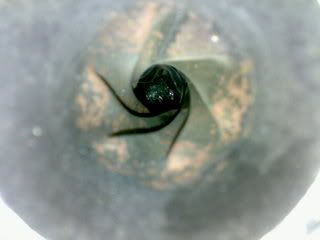

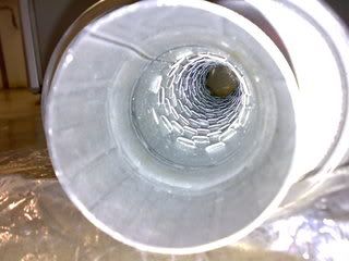

My personal opinion is that:
Swirling bullet/midbox helps to create backpressure. (only helps auto transmission)
Normal midbox or normal bullet is straight flow where u can see a straight hole from one end to the other.
Pictures for a swirling midbox and a swirling bullet from one end to the other end:

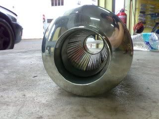

A sample of Straight flow bullet:
Hope you understand by now.
