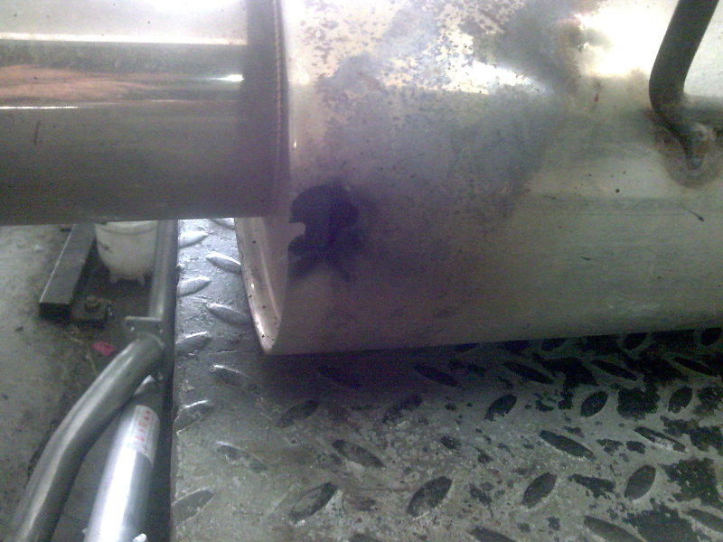

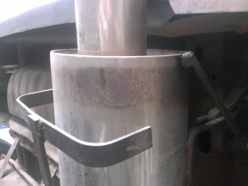

u are good in exhaust, but y ur company importing such quality from taiwan, it's really make me wondering that are you really import from taiwan?
it's 'karat' and somemore got hole.
the karat can be material defect but you all still importing it in?
as for the hole, is it due to the welding skill?
