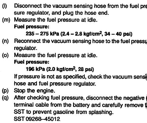

FYI, Toyota factory fuel pressure specification for 4AGE 20V AE111 blacktop. Idle: 28psi, Load: 34-40psi. Refer attached image from the 4AGE Engine Repair Manual.
