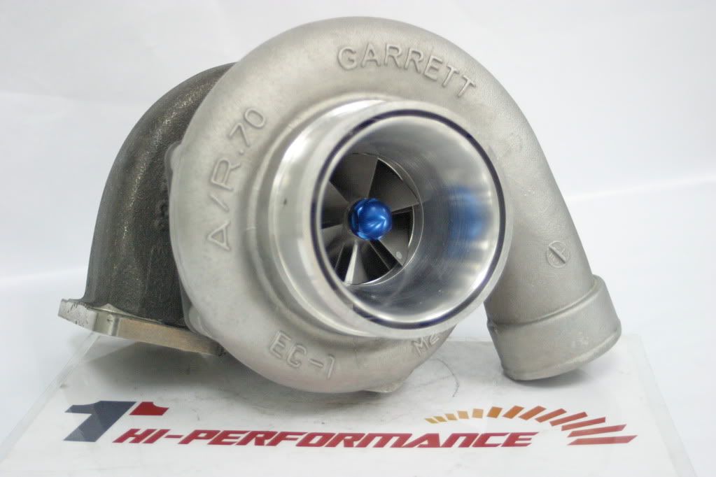

Cool...Btw SDF, can share some information/specs you know about APEX'i turbo series (but now Power Enterprise..i think.) normally use for evo...example the RX6 got p18 and p20...AX series???:confused:
we have some info on these..lemme go dig and scan the article for you. As you already know..the P18 or P20 = the turbine volute area aka a/r. IHI uses cm2 to measure and it's different from Garrett. The RX series unfortunately isn't as versatile as Garrett or other makes, they only came out with RX6 and RX7 series.
RX6 is based on the IHI RHC6 frame but mated with the smallest turbine wheel and largest compressor wheel within the series.
RX7 is based on the IHI RHC7, RHE7 frame series.
The ball bearing system is different with Garrett, it runs 2 high speed ball bearing cages coupled with a spring in the middle , whereas Garrett does it differently with a solid machined cage to hold the bearings for both ends.

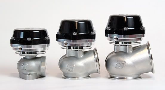

3) twin 38mm wastegates
PM me the specs and price
1) HTA 35r 82ar.. nope..it's FP's baby.. we have GT3584R (using T04Z wheel)
2) Twin scroll mani.. nope, some shops here custom make it..possible
3) twin 38mm wastegates ... sure.. we have many wastegates.. how many would you like ? ;-)
