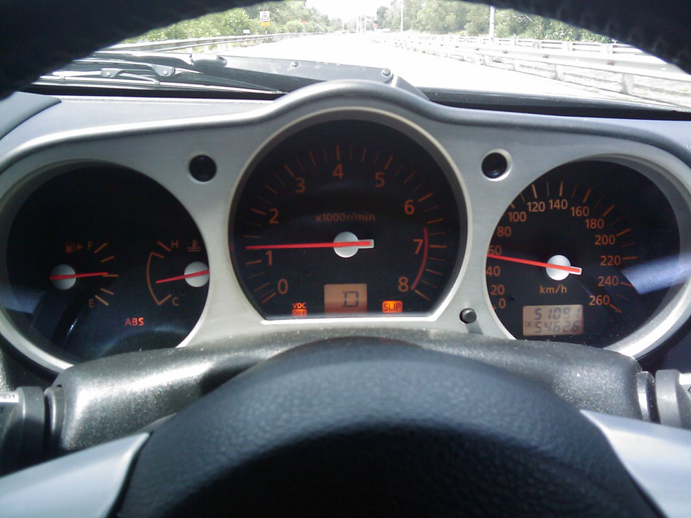

The engine warning, TCS and SLIP lights all came out suddenly, and it also slow down the engine for you not to accelerate, jz good enough for driving home... Anyone can help???

Basically, TCS and Slip lights up when the sensors detected too much different of rotation speed/rate on each tire. Example, if you put 245/45/18 on your left rear wheel and 245/40/18 on your right rear wheel, the light will on after some distance of travel.
There might be some other reason as well, I think experienced tire shop can help you.

im not sure if its the same or not. this was the problem i had before..
mine used to lights up the VDC, SLIP and ABS. ask other 350z forums and they ask me to check the brake pads..
it might lights up if ur pads is thin. after u change the pad, check if ur brake oil is inline with the F indicator at the brake reservoir.
all the warning lights was gone right after that. if yours still on, i thinks its because of abs faulty sensors or worst case faulty ABS. because u told me that ur engine is slowing down.. just my 2 cents here.
