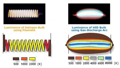

HID have different light 'source' or arc compare to halogen. thats y its blinding when fitted into open reflector headlamp. especially H4 type, some i saw doesn't have any shield.. its like HI-beam with brighter output.. :banghead:
attachment.php
for H7 type still acceptable coz the reflector design.. but more preferably if can get H7R type HID bulb. got some shield 'painted' into the bulb capsule to reduce glare/blinding light.
