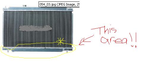

btw, juz found out that there;s water+coolant outside of the radiator's bottom. Somewhere like in the pic below...what causes that?
p/s sorry bout the ugly writing...

owh..dats radiator lower cap. BTW, what kind of radiator you used? last time I changed my upper cap + inner ring + radiator service = RM180 for an EJ radiator for OEM Honda. Local one should be RM150. This is due to this cap was leaked.

That's pretty obvious isn't it? There's probably a leak.. unless someone was pretty clumsy while pouring coolant down that tiny radiator hole (happens to me sometimes as well :P)
Well.. cooling problems are usually localised to the parts mentioned earlier, so check one by one and change them.
The radiator is probably the only problem, hopefully, but if the car has been poorly maintained.. well.. long road ahead for you I'm afraid.
