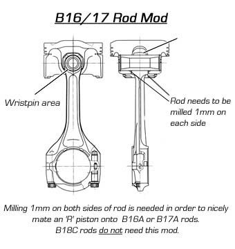

so what's the conclusion on putting a b16b type r into b16a standard block. it is reliable & performance wise? just plug and play rite?
its not pnp... u need to mill the conrod.. perfomance wise will give u better compression.. the disadvantage, it will give u less piston-valve clearance...
lots of b16a with pct piston end up by rip... hehe

putting a CTR piston into b16a block will require some machine work on the rods and also some TUNING to suit your engine application. some ppl may have extractors...some ppl may be using 80mm throttlebody...some ppl maybe using malaysia boleh 1 piece gasket. the tuning part is the key factor. all untune cars are consider highly explosive on the road when it starts to detontate. safc, hondata or whatever ure using must be tune to suit your engine.
