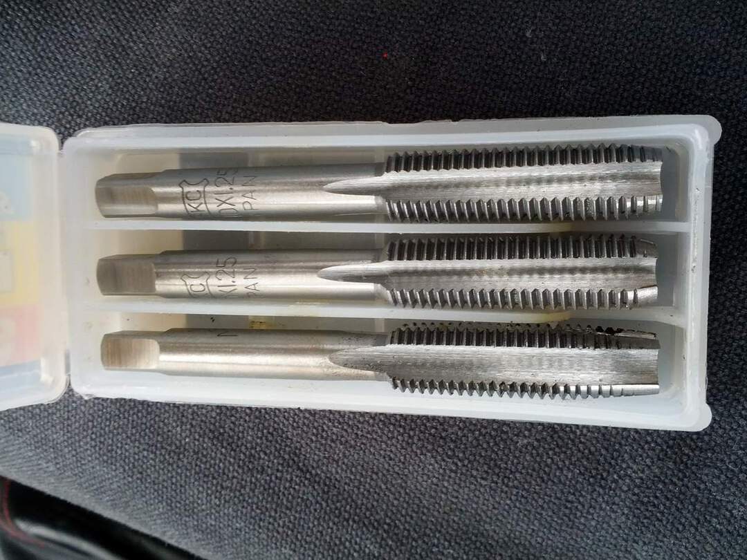

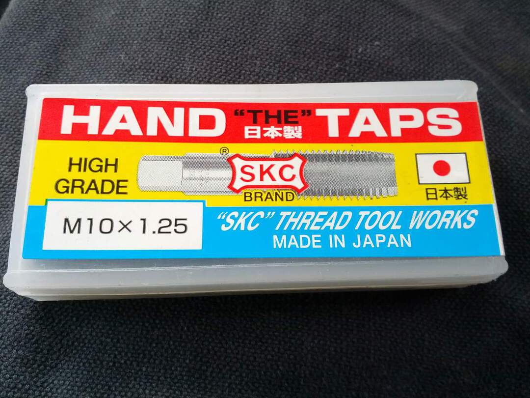

Problem solved. Bought the tool and re-thread the nut. Actually it's pretty easy coz original thread is there.
Use longer bolt and wrap it with white tape to make it tighter a bit. Hand tight the bolt. Tadaaa....

Congrt..:congrats: warrgg!!! sory..sory..i'm wrong :banghead:about the thread..its 1.25..always confuse coz some car model share and some not...:adore:
