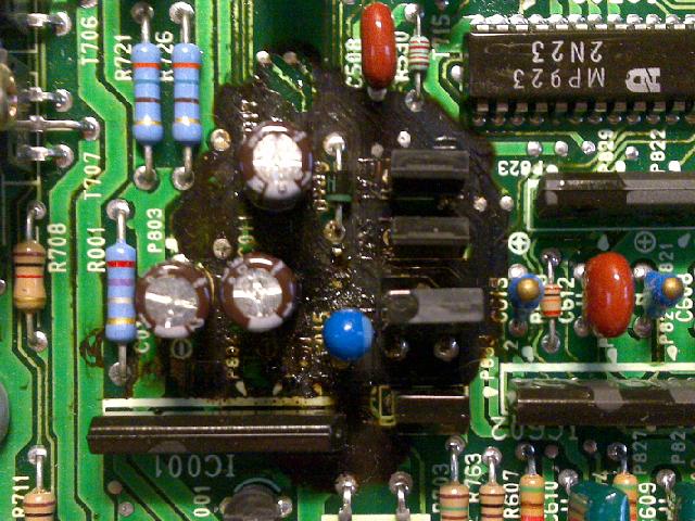

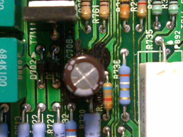

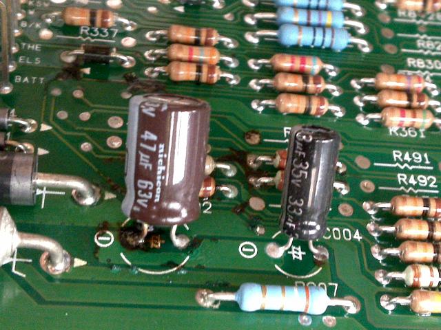

Hi Veloc,
Straight flow muffler does increase the FC on the auto tranny. I experience it on my silvertop engine few yrs ago. But for safe, i would suggest the following:
1) service throttle body, check air filter and s/plug
2) check ECU (see below)
3) change back to stock muffler
*How to check the ECU*
Warning: Do not attempt to do this if you are not a hands on person
1) Turn off your engine
2) Remove EFI fuse (15A) and wait for 10 mins for the ECU to completely discharge
3) Pressing the connectors and carefully pull out the ECU - becareful not to pull off the connector's wires. There are total 3 connectors that need to handle
4) DO NOT touch the ECU's pin
5) Open up the ECU's top cover (DO NOT touch the components) and inspect the board conditions
6) If there are a black stain mark around the capacitors, you have a faulty ECU. Replace the ECU ASAP as it may stall your engine ANYTIME!
Black stain mark at NG ECU.

Hi Veloc,
