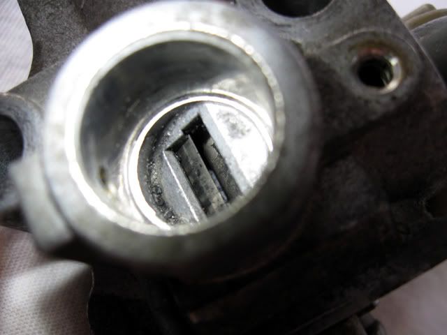

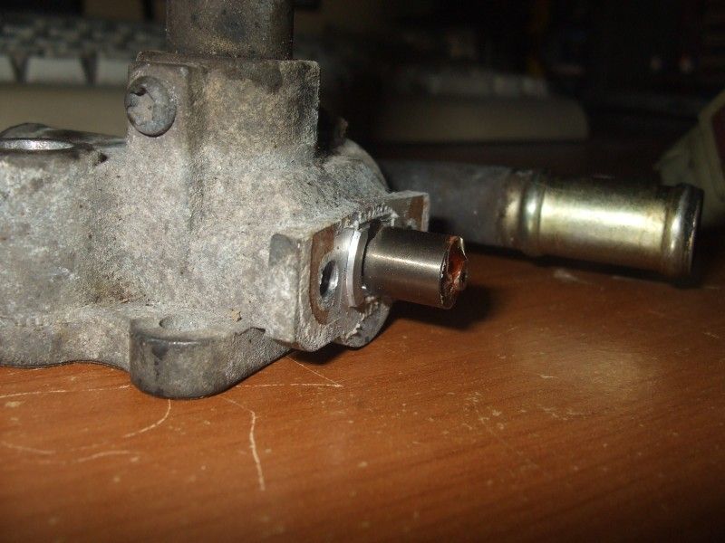

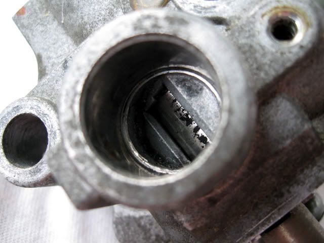

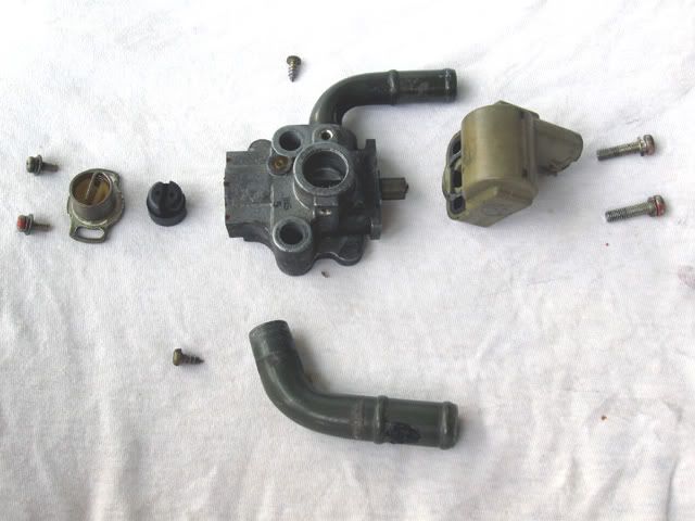

U can see ur iscv clean or not. U need to open 2 pipe & see ur iscv valve clean or not. Normally iscv control engine warm up. Input voltage 12vdc. When u start ur engine, electromagnet will close valve slowly ( voltage 2 wire +/- 7v & +/- 6v sent signal to ecu ) and input voltage stay +/- 13v (alternator voltage). RPM from +/- 1300 to 950.
RPM 1300 = -7v & -6v
RPM 950 = -8.5v & -4.5v
If ur idle start low rpm (500 rpm), maybe signal wire cannot sent signal to ECU or open circuit. For 4age blacktop, ECU automatic up ur engine RPM in 4 minutes to normal idle not for 4afe.
