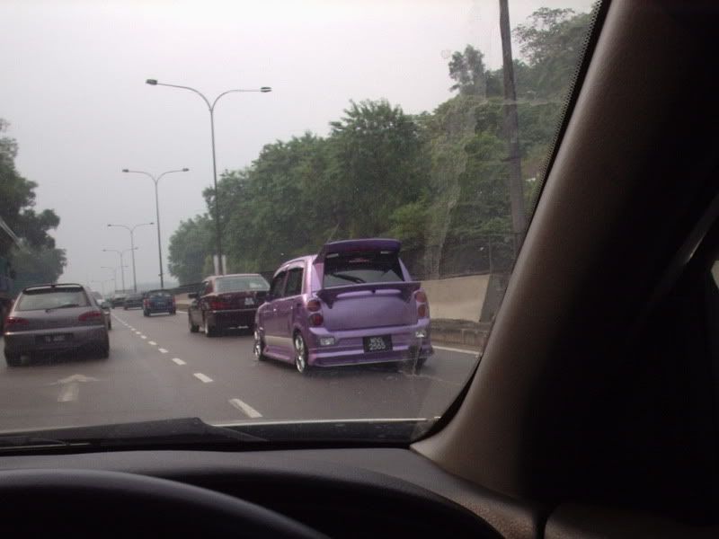

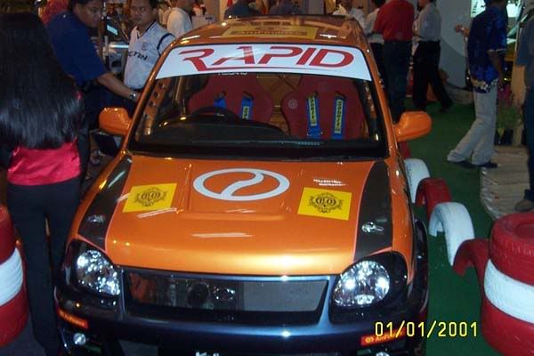

nsboy said:
kelisa.
1. wat turbo engine can go into a kelisa??
2. wat body work can go into the kelisa 2??? price???
do advice me thanx..
http://img341.imageshack.us/img341/5867/imga0705xa8.jpg
http://img439.imageshack.us/img439/2789/imga0709sf3.jpg
http://img429.imageshack.us/img429/1985/imga0711kf7.jpg
http://img53.imageshack.us/img53/1205/p10jx5.jpg
http://img147.imageshack.us/img147/1522/dsc02103jj4lb1.jpg
hope this can help u a bit
