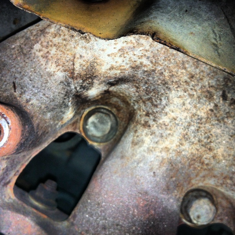

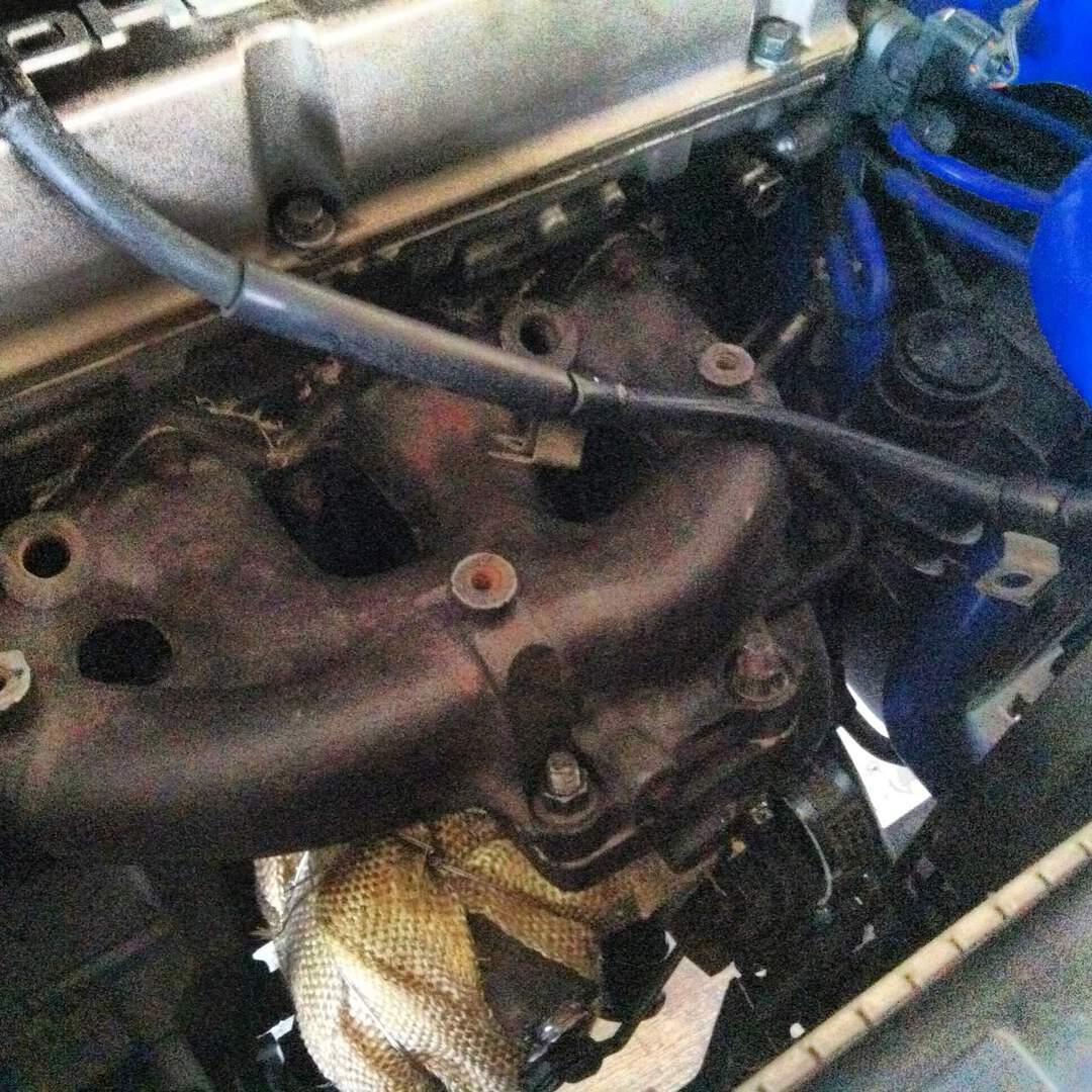

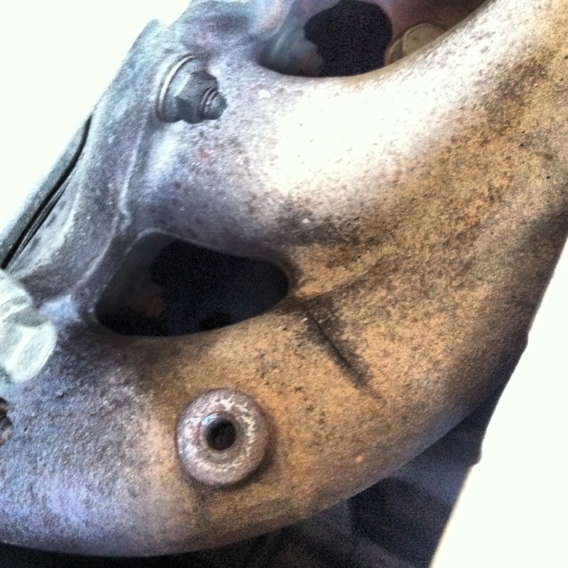

Ah Wah said it's pretty common for the original manifold to crack. Well, it's time for me to upgrade to TD05 + FMIC. Will keep the progress update here... project begins next week.

Yep.. Mmg normal the cracked manifold.. Had mine change 2 yrs ago....same spot like u... A hairline crack.. Luckily found a replacement at chop shop... Price rm350 and I sprayed ceramico coating to protect it from cracking again...

Yup. When engine is cold, I hear pretty loud whistle sound. Hoping after the fix, I'll get better performance too. ;)

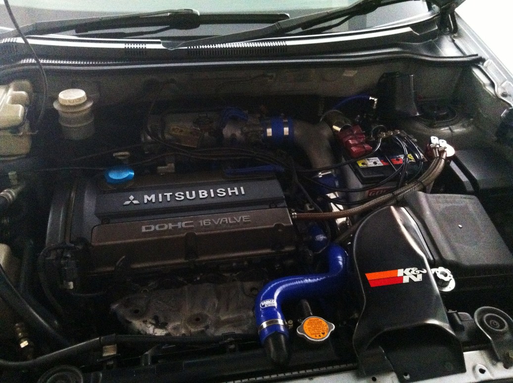

Ah... is it? Anyway, it's already wrapped at this point of time. Just some pictures to share.

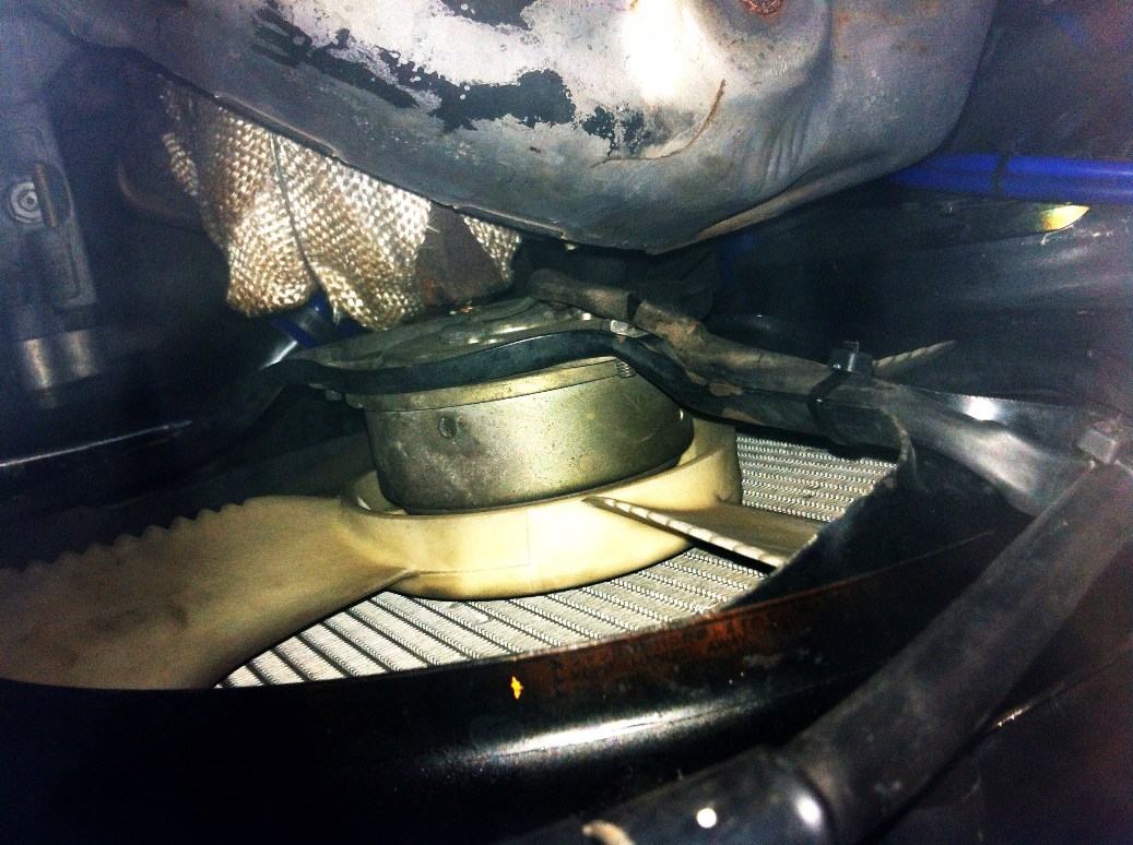

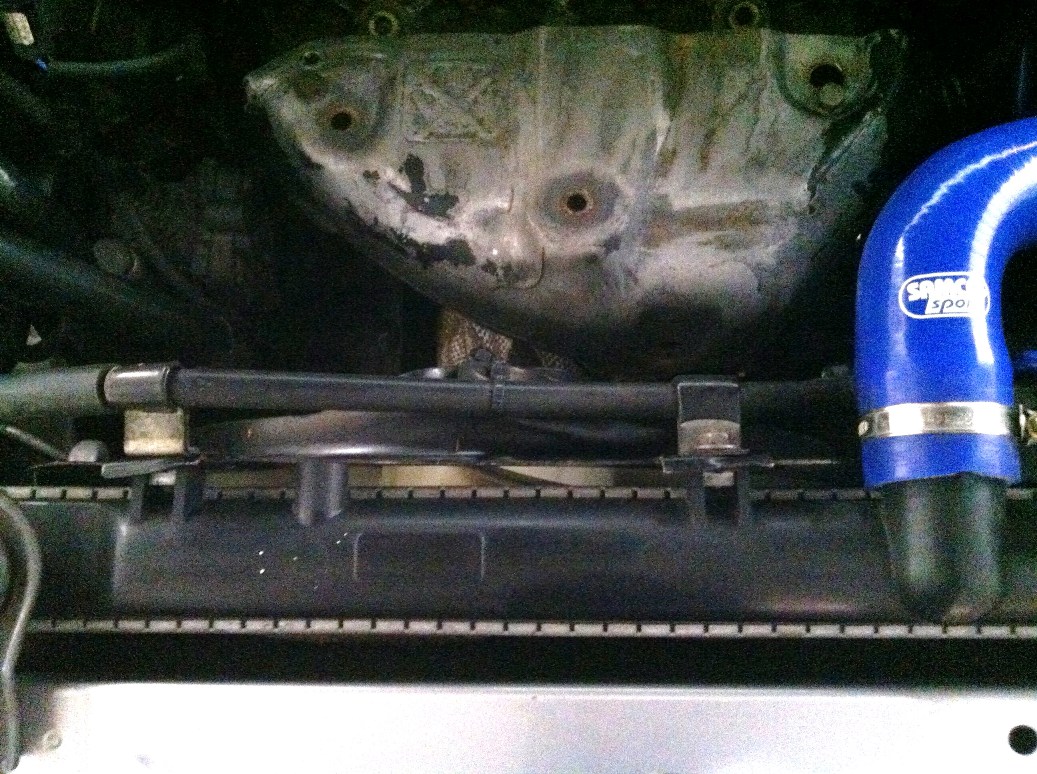

Weird,
I thought when you dump in a TD05, they have to move the fan to the front cause will kena the turbine compressor housing. No meh??
Won't lag ka TD05? You would be better off with a TD05 from an E4 to E6 cause if i remember correctly its smaller then the 05' from an E7.
re: Manifold Cracked & Turbo Upgrade
Weird,
Yes, the fan needs to be modified. It's not done yet when the picture was taken.
I've NOT driven the car yet, so I don't know about turbo lag yet. Will share when I got the car today I hope.

stutzedward~~~can u post a pic that where u relocate ur fan ~~using the ori one??or other??
I just finished washing the car. Forgot to take picture la. Wait I take tmrw n post up. It uses the original fan motor. Ah Wah is great, he's able to mod it to fit.

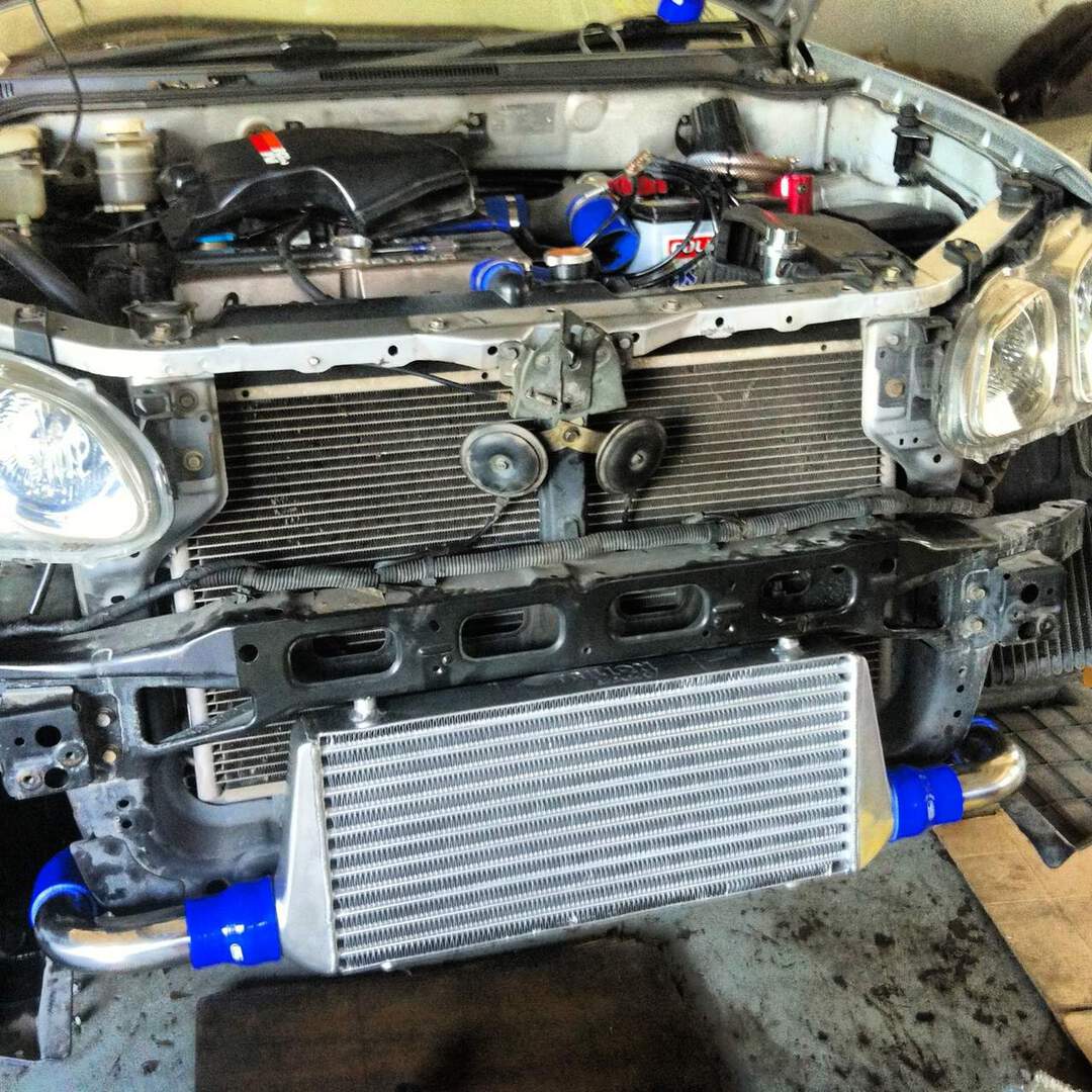

Sharing pictures as promised. Today is the 2nd day driving it. It was a very very hot afternoon and I noticed the car is much stronger in the afternoon. I know conceptually FMIC is better than TMIC during hot days but this is the first time I am experiencing it. Knocking is lesser and it pulls stronger and smoother. Yes, it is more power than my previous setup during hot weather. :)

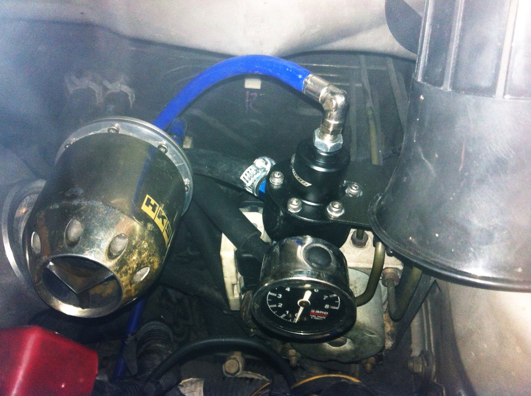

Works Fuel Regulator. I am also retaining my original HKS bov with the original HKS piping used previously for my TMIC.

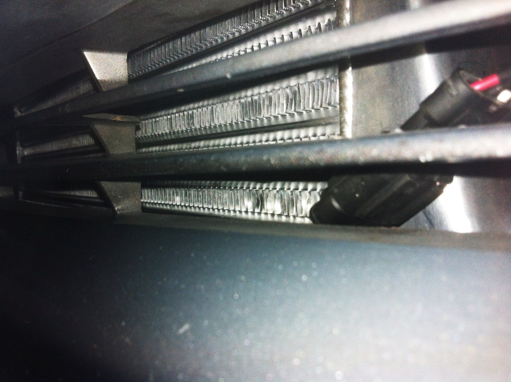

Intercooler hidden behind the front bumper. It's stealth as original.

Pictures of original fan motor modification as promised.
attachment.php
attachment.php

Question about the radiator fans, did you keep both original fans with just a minor modification to the one closest to the turbo? Do you know details of what Ah Wah does so everything fits?
