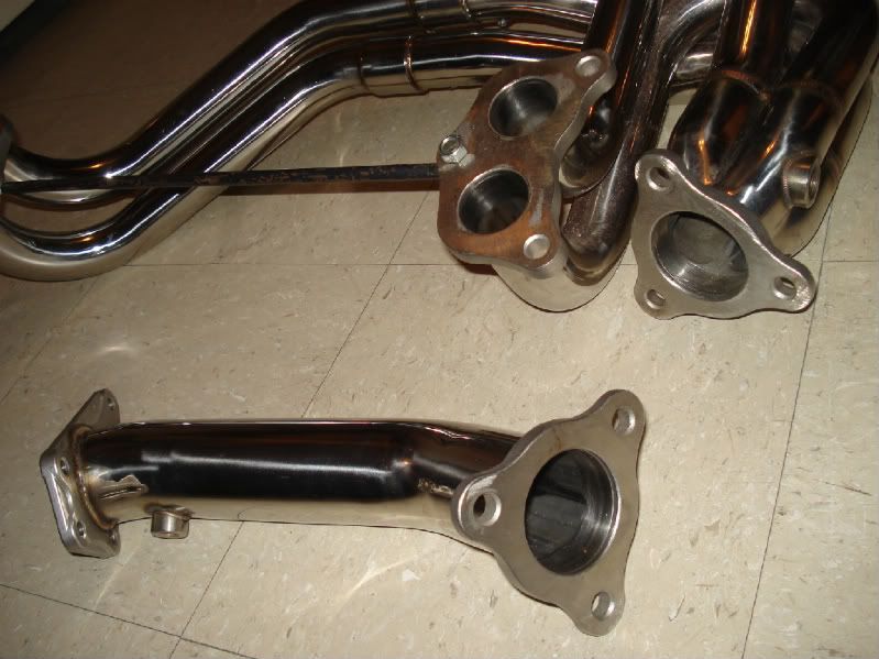

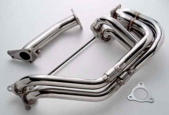

bro,do u know the subaru standard turbo header how many long?of course will got abit lag,they normally will use ball bearing turbo,subaru is using boxer engine the turbo header pipe is going out from two place,if the brand new banana is long also,please see the picture why the lancer evo no need to use small turbo?coz the 4g63 is line 4 engine,the banana not so long,lol![]()
