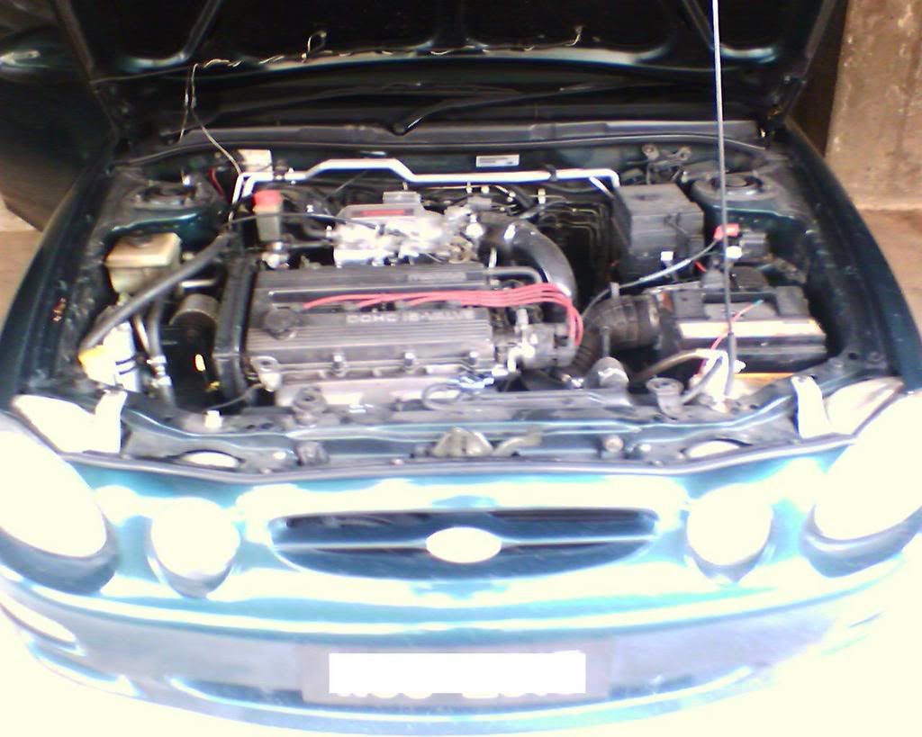

so u change to B8 wat about ur chassic of ur car...can take it ar?....
proses nak replace dlm mase 3 minggu
x der potong2 mounting
wayering rojak 99%
workmanship mahal skit r
1500+
hallfcut price dlm rm3800
driveshaft kene pegi custom
4wd gearbox tak boleh pakai
lock ratio
60% rear
40% front
rugi 60%
so need to buy other gearbox
for pickup use 1.6 gearbox
best 1.6 b6 lsd
tapi susah dapat n mahal
or can use 1.6 b6 without lsd
tapi kalo main topspeed kurang skit r
long distance makan minyak
sbb kia sephia n spectra
body berat sgt
kalo nak long distance n jimat minyak pakai
gearbox 1.8
x der problem lepas pakai
aku bli halfcut b8 baru jalan 11000km
so cantik lagi
just servis jer la

aku wat enjin kat kL la....
wokshop tu skali dgn halfcut
B8 tak der jual enjin saje
so gearbox 4wd tu simpan je la
yup aku bli gearbox lain
gearbox astina 1.8
rm1000+
driveshaf custom x ingat baper aku wat

my b8 turbo la.....

u mean my turbo from wat car?..........i rojak banyak......haha
turbo from subaru.....at first nak masuk nissan 1...but subaru better....hoho

my engine got stil the same......
but change the injectors using audi....haha
but now my power oso good aredi.....takkan rio masuk track kan....haha
boost 0.5 -0.7 good enough, later gear box pecah thn habis......
mine rojak gila.....intercooler using nissan march...... if got chance i will post my car pic.....but now haven habis , so still have to wait..... tats why i keep finding info for kia rio.....cuz dekat KL not many ppl modi kia.....haihs
