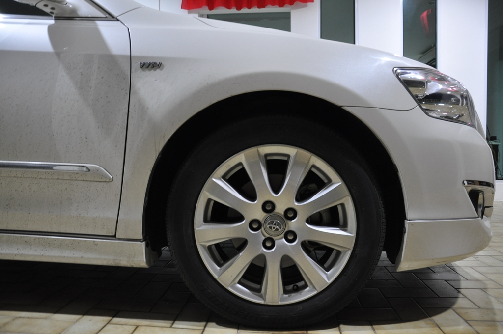

what i did was a midnight detailing section
b4 detailing starts
http://4.bp.blogspot.com/-gXR-Yg-Lnms/T0uiV3p7QzI/AAAAAAAACII/TgMmeLiC-hc/s1600/DSC_
starting to see some minor scratch
with lightning, after ONR washed
minor swirls
minor hologram
http://3.bp.blogspot.com/-x1IYJdQj4zQ/T0uhtme32lI/AAAAAAAACGY/H4yCcYLBrpQ/s1600/DSC_0671.jpg
minor scratches as well
http://2.bp.blogspot.com/-hwZnAKSQqHo/T0uhthCqNyI/AAAAAAAACGI/cSWZVuAxL9Y/s1600/DSC_0672.jpg
interior b4 detailing
interior after vacuumed, steamed & leather protectant applied
after~~~~
i did all the followings for the paint job:
Clayed with ONR as lube
Compound with M105 and LC compound pad
polish with Opt hyper polish and LC polishing pad
Opti sealed
Opti wax
the very next morning 6.30am, reflection test
http://2.bp.blogspot.com/-0Qj-craEztc/T0uhbzrViXI/AAAAAAAACFo/MwwTNGUIyPE/s1600/DSC_0677.jpg
had this hard work for 11hours through midnight
thanx for viewing!!!
