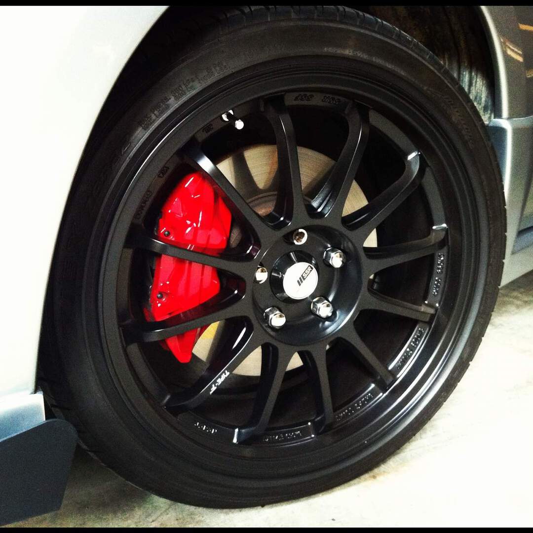

And the 4 pots caliper.
http://carphotos3.cardomain.com/images/0015/17/46/15697164_large.jpg
http://carphotos.cardomain.com/images/0015/17/76/15697167_large.jpg
attachment.php
Behind the wheels.
http://carphotos4.cardomain.com/images/0015/17/56/15697165_large.jpg

I changed at Ah Wah's place for Rm1600. Yes, it includes painting and before you go, call him and tell him the color of choice of your preference. It's one of the mod which I like most on my car. Coupe with fine spokes rims, it'll look just great. Hehehe...
attachment.php
And if you compare, even Taiwanese 4 pots with disc are around RM6K nowadays. So this is really a bargain. By the way, the calipers are SUMITOMO from Toyota Soarer/Supra.
