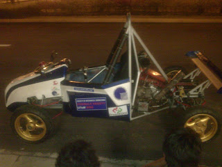

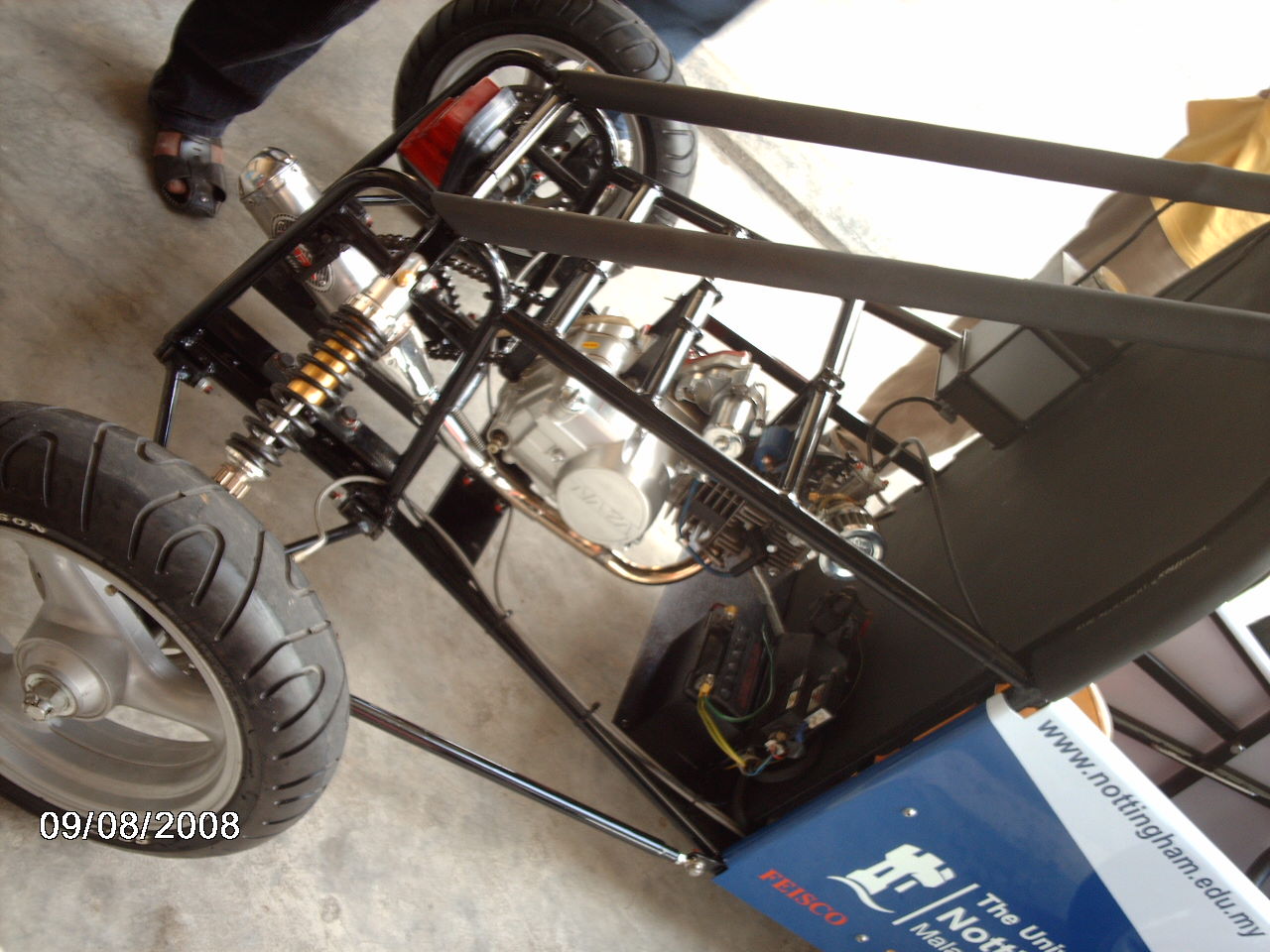

now refer to the two pictures of formula varsity... no doubt alot of time, blood and sweat went into these cars.. so i salute those who put the effort into building these cars.. i've spent many sleepless nights building my own just to see the chequered flag let alone the podium...
these two cars lack the fundamental importance of a race car (among the other issues you guys have raised).. the chassis.. more importantly the torsional rigidity.. suspension and chassis guys will tell you that a perfect race car gets ruined by the driver and the engine.. this is because of the cavity needed to house these two items.. the example is simple... is you have a match box with the drawer of match in it.. it is a strong structure.. when you remove the drawer (where the matches lie in) the whole box becomes flimsy.. these two cars are essentially the match box without the drawer...
there is not enough triangulation in the chassis.. particularly where the engine lies and where the driver sits in.. if you disregard the shocks and replace them with solid shocks.. i would bet my ass on the line that the chassis would flex in bending and in twist...
so what happens then is that the energy needed to conduct the weight transfer from one shock to another is taken up by the chassis in twist.. hence resulting in an inefficient chassis ie a 'lazy' car....
i tell all my clients that engine power is important.. but it doesn;t win races.. you need balance..
but for what i see in F-varsity.. an overengineered, light chassis is the winning formula.. afterall.. how much power can you crank from a mat rempit engine?
not bad.. at least i got you guys thinking...
now the next step is to prove that i am wrong.. how do we measure tosional rigidity? afterall.. what i'm saying is just words.. we're all men of science.. how do we obtain a scientific result to prove that our chassis is indeed strong?
